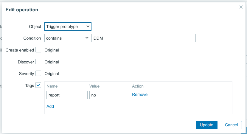

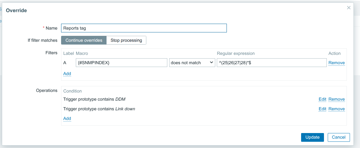

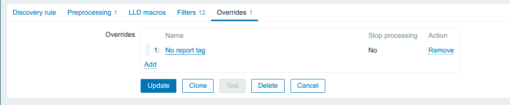

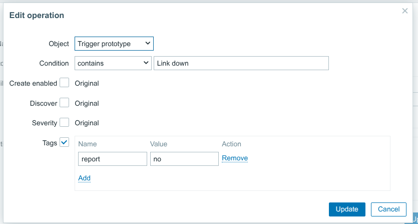

    I would like to add special tag "Report: no" for some ports on a switch, in order to skip sending alarm via telegram for these specific ports.

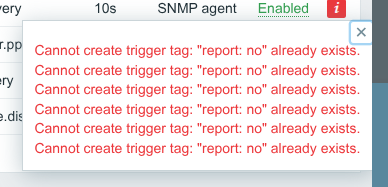

    I added "overrides". However tag is not created with error "cannon create trigger tag: "report: no" already exists"
    I am using zbx 7.0. What am I doing wrong?

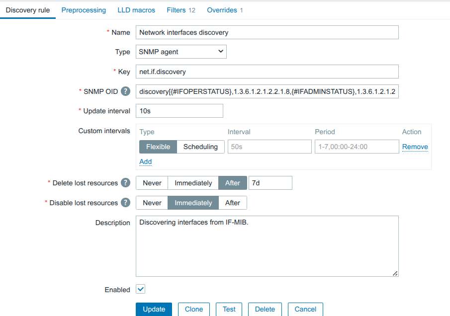

    Here is the error itself
