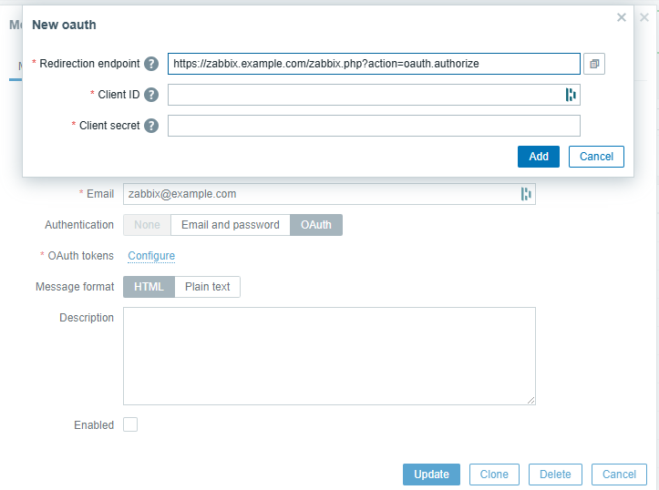

                        • WheelerMike
                          • Mar 2026
                          What did you use for the Redirect Endpoint and the URI for the Entra App? I've tried https://SERVERIP/zabbix/zabbix.php?a...auth.authorize and https://SERVERIP/zabbix/index.php?ac...auth2.callback and neither works.
                          • MarcP
                            • Mar 2025
                            For Redirect URI in Entra ID (App registration -> Authentication) I just used the default one which Zabbix provided me when I added a New oauth.
                            In your examples, it seems to be the first one. I never checked if it works with an IP addresse though.

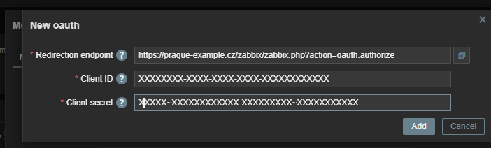

                            • Tomyyx
                              • Apr 2026
                              #15
                              Fixed it!
                              ( recommendation Do it in Incognito mode / after clearing cookies)
                              1. Frontend URL: Go to Settings ➔ General ➔ Other and set your Frontend URL (e.g., https://XXXXXXX.com/zabbix tested - https://prague-example.com/zabbix).
                              2. Config: In the authentication settings, ensure the following are filled:
                              3. Click add and sign in Microsoft account
                              4. complete:
                              Ask me if you need specific help, you dont need to allow all tenants, or do it on server.​
