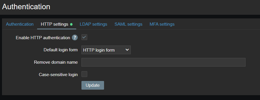

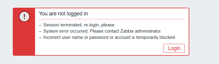

        Yes i am trying to login to Zabbix using http auth. I am gonna be using proxy so i don't need to create another file what i may have missed is that i want to know ​is how to configure it on server not on web-server but on my VM. So some thing i missed as well is that i have zabbix in docker container and am using nginx.
        I will add some pictures what kind of error i got after enabling it on web server.

          • 5002
          You need to configure this on your webserver... You are giving all auth duties over to a webserver and do not switch it on (in zabbix UI), if it does not work properly...
