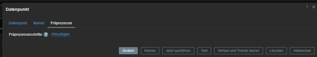

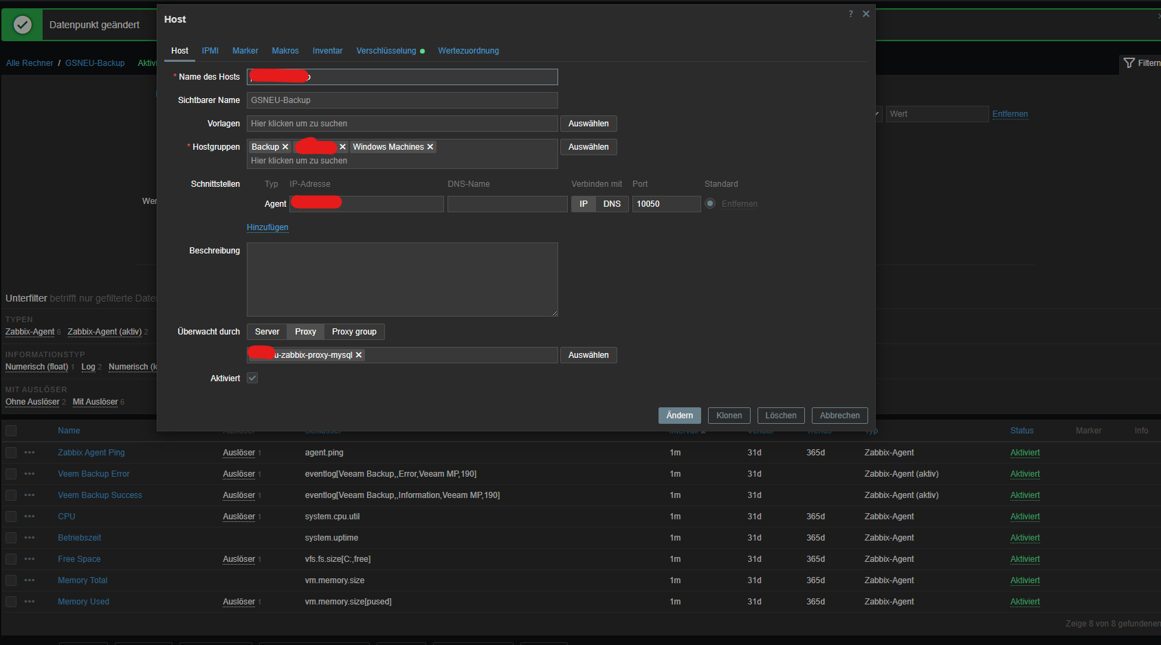

        • elias411
          • Jul 2025
          ​No preprocessing rule.
