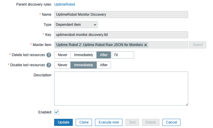

    Hello zabbix community,
    I have been working on a template that connects UptimeRobot and Zabbix. For the connection I am using the API provided by the UptimeRobot and in Zabbix I am using JSON to read it. The UptimeRobot API information I am getting from this link. The template code can be found on my github. The templates works perfectly when using zabbix version 7.4.0rc2 (tested on two separate instances), but it refuses to work on 7.2 (tested on two separate instances, one is a fresh install). The templates properly connects and can read the JSON, but when it comes to low-level discovery it gives me the following errors for both the lld's. If anyone has any suggestions how can I make it work on the zabbix 7.2. I have double and triple checked if I have any duplicate keys, I DON'T.

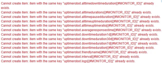

    Error 1.
    Error 2.
    Image of the preprocessing step in the discovery.

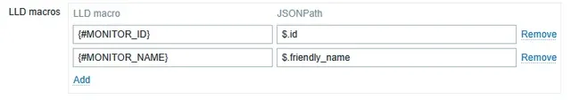

    Image of the LLD macros in the discovery.

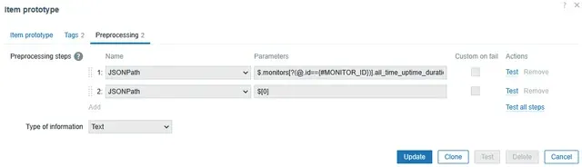

    Example of an item.

    The problem was fixed for Zabbix 7.2 by removing the LLD macros in the discovery rule. The updated code is available on my github.

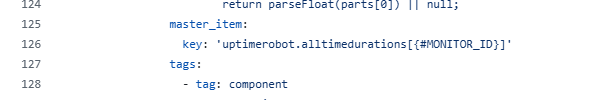

      As you say works fine on 7.4 and not on 7.2 and having a quick look at the github template.
      It looks like a new dependant discovery rule is used and that feature is only available in 7.4
      As I don't have a 7.4 running I can't say for certain but this line triggers my assumption: Click image for larger version
