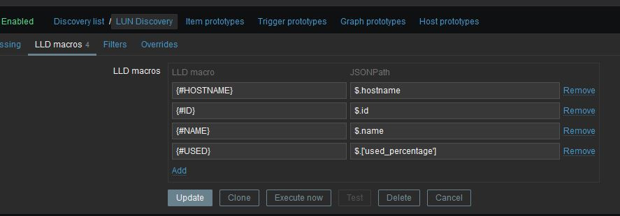

    Hello Zabbix Community,
    I try to display every element of a json array as a Honyecomb cell in a dashboard.
    I use zabbix_sender to send the JSON to my Zabbix Trapper Item. This step works already but now I try to split every element with a discovery rule and Item Prototypes, the whol LLD stuff etc But I just cant make it work. I watched a ton of videos on yt and such but didnt find a similar usecase.
    The json looks like this: [{'id': '430', 'name': 'TestVol1', 'used_percentage': 92.58}, {'id': '693', 'name': 'vol1', 'used_percentage': 75.0}] Thats how it looks in Latest Data of the Trapper Item.
    Can anyone tell me the way from here?
    Here is my Discovery Rule:
    Click image for larger version  Name:	discoveryrule.jpg Views:	6 Size:	53.7 KB ID:	505800
    LLD Macros in the Discovery Rule:
    Click image for larger version  Name:	LLDMacros.jpg Views:	4 Size:	44.1 KB ID:	505801
