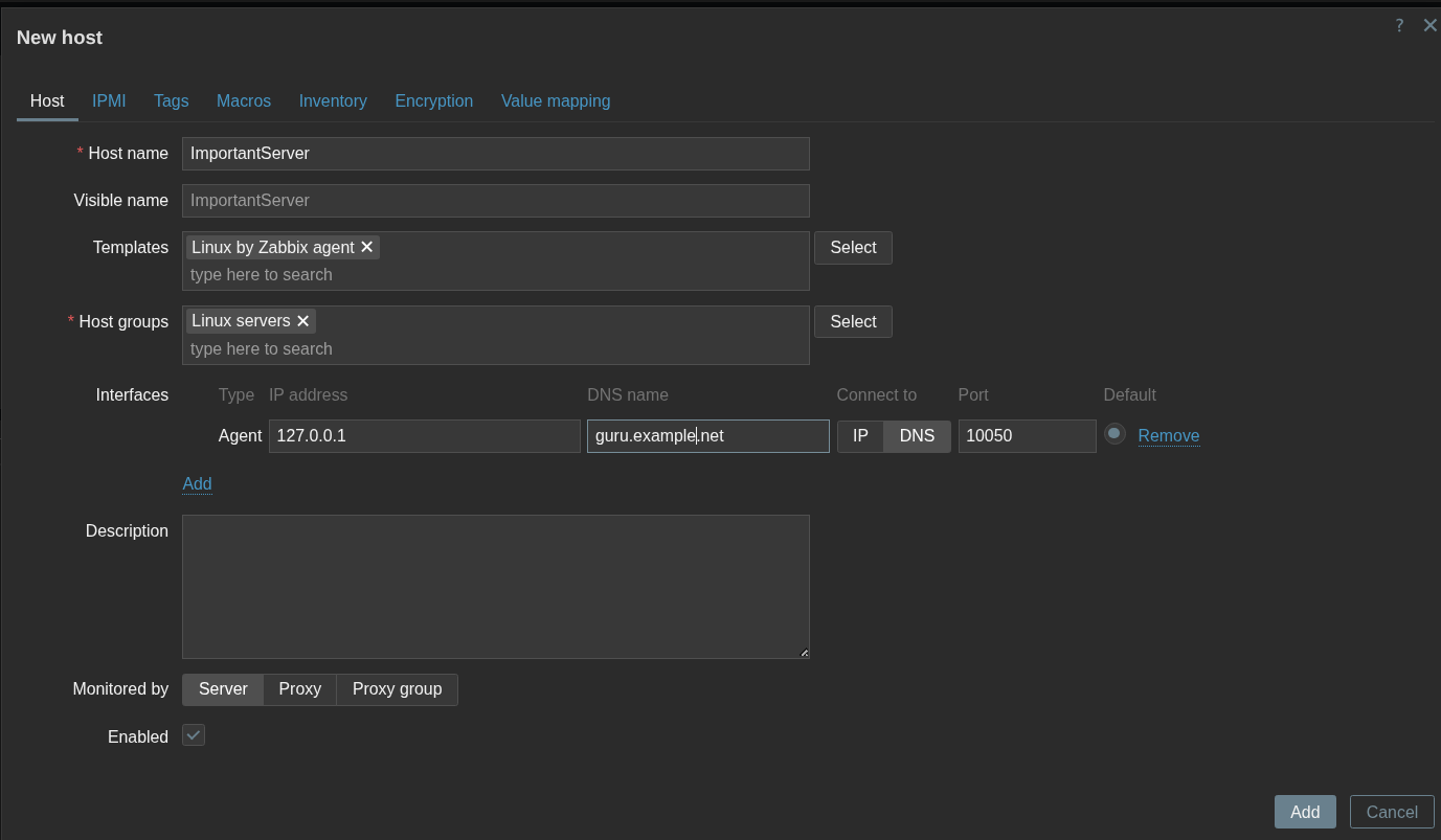

    First I installed the zabbix-agent on the Debian 12 host I wanted to monitor, updated the /etc/zabbix/zabbix_agentd.conf to contain Server=192.168.37.42.
    After restarting the agent, I attempt to add the server in Data collection/Hosts, this is the critical point:
Name:	Screenshot from 2025-08-07 12-05-37.png
    Because both the IP and the dns-name is set, the IP is saved and used. This is not obvious later in the WebUI...
    Now the discovery takes over and starts collecting information from the host, but not as I expect.
    It collects from the Zabbix server (127.0.0.1), not the one stated as guru.example.net. The effective Agent interface is 127.0.0.1:10050, not guru.example.net:10050.
    I lost a full day on this, thankfully everyone is still on vacation, so this time no disaster....
    My resolution was to remove the dns-name and update the IP, and Connect To, then save and restart everything.
    Oh, and there seemed to be issues with remnants in the database some time along the way, I think the updates are inconsistent in some cases...
    Once update, I triggered the discovery, navigate the list of hosts in Data collection/Hosts and find the discovery items....

                            Anyhow, by switching to stating IP instead of DNS-name I suddenly got the right data alltogether.
                            So, the workflow and the critical part:
