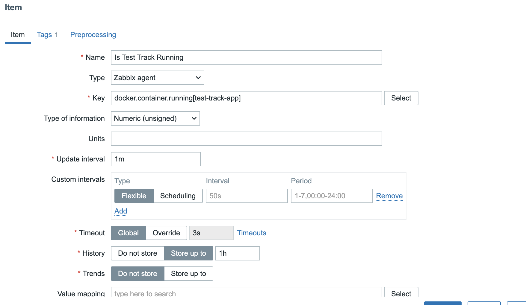

    • chrisfromdevso
      • Aug 2025
      Originally posted by cyber
      I think (I am not using that docker template myself), that shutting down a container, is totally normal behaviour and template just considers it as changed situation, no need to monitor that one any more etc. If you could kill that container somewhat abnormally, then it might trigger something..
      I ended up creating a trigger like below, works consistently and avoids the weirdness of the auto discovery

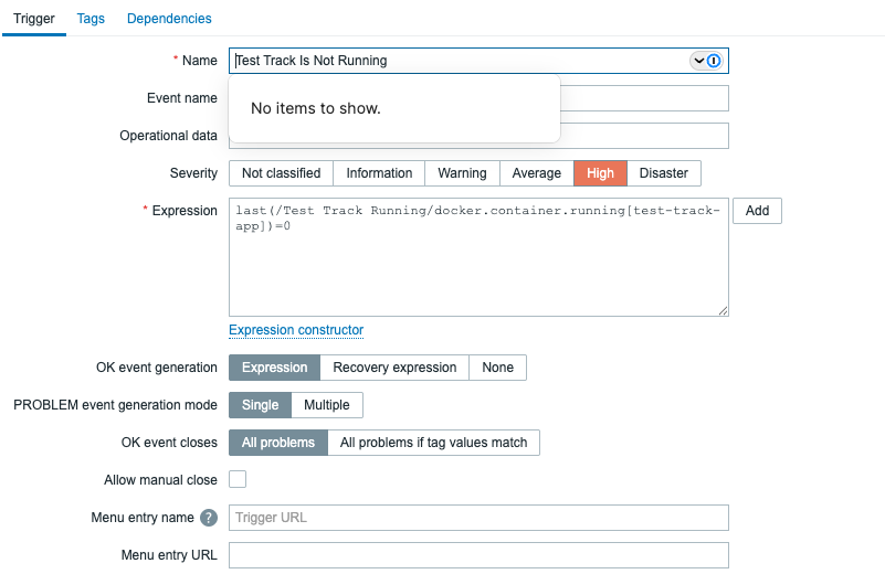

        • 5008
        Thats the item, not trigger.. Just as it says in top left corner..
        • chrisfromdevso
          • Aug 2025
          Very true, missed that one, its the item that's useful in this case though, the trigger is the result of this item == 0 means the container is not running. but for completeness the trigger is below
