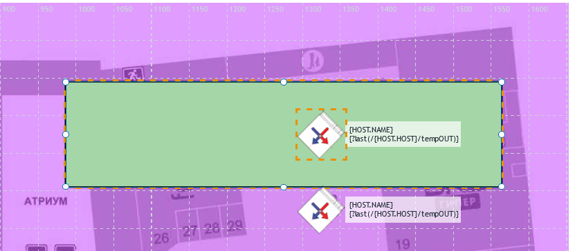

    I Made in zabbix monitoring of the temperature of air handling units.
    I want to divide the map into areas (like an air handling unit serves a given area of the room) - using figures and change the color, depending on the state of the trigger
    Each figure is linked to its host (accordingly, linked to the host trigger)

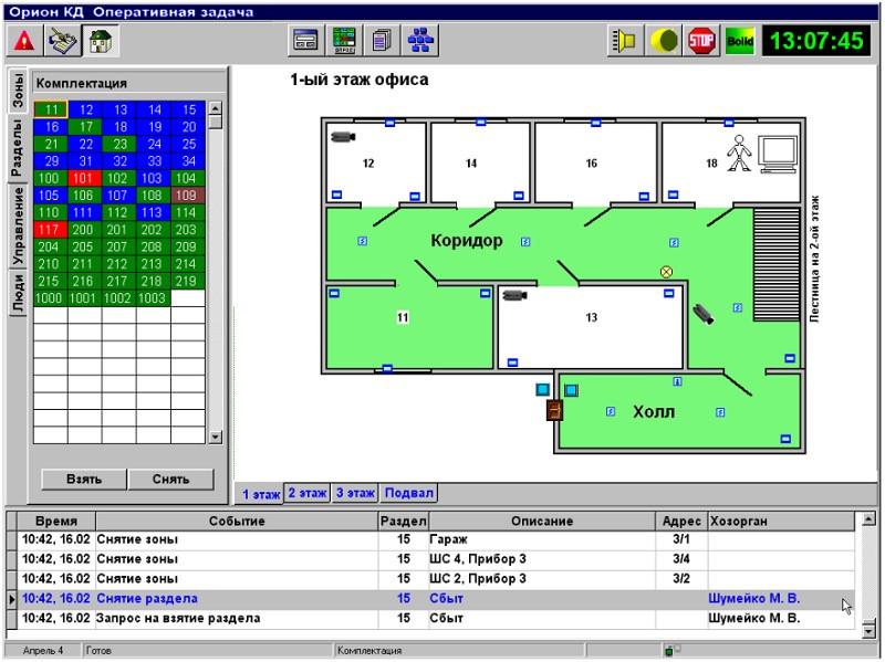

    like in another software:
    Currently it is not possible to link a figure to a host, perhaps this can be done using macros?
    Has anybode done something like this?
    Maybe share the code?

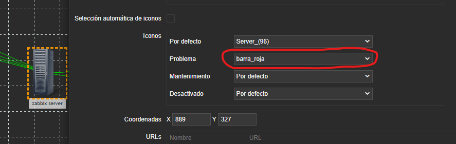

    hey i been triying something i added an icon on
    Administration > zabbix > images called barra_roja that means red bar
    the idea is this in the map configuration there is this option that allows to change que shape of the host and i put the red bar the one that i manually added
    Click image for larger version  Name:	image.png Views:	0 Size:	29.3 KB ID:	506315

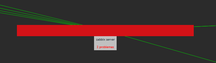

    so if there is a problem it apears like this
    Click image for larger version  Name:	image.png Views:	0 Size:	8.7 KB ID:	506317
    what i mean by this is maybe adding icons for green floor or red floor and whit the letting them change if there was problems

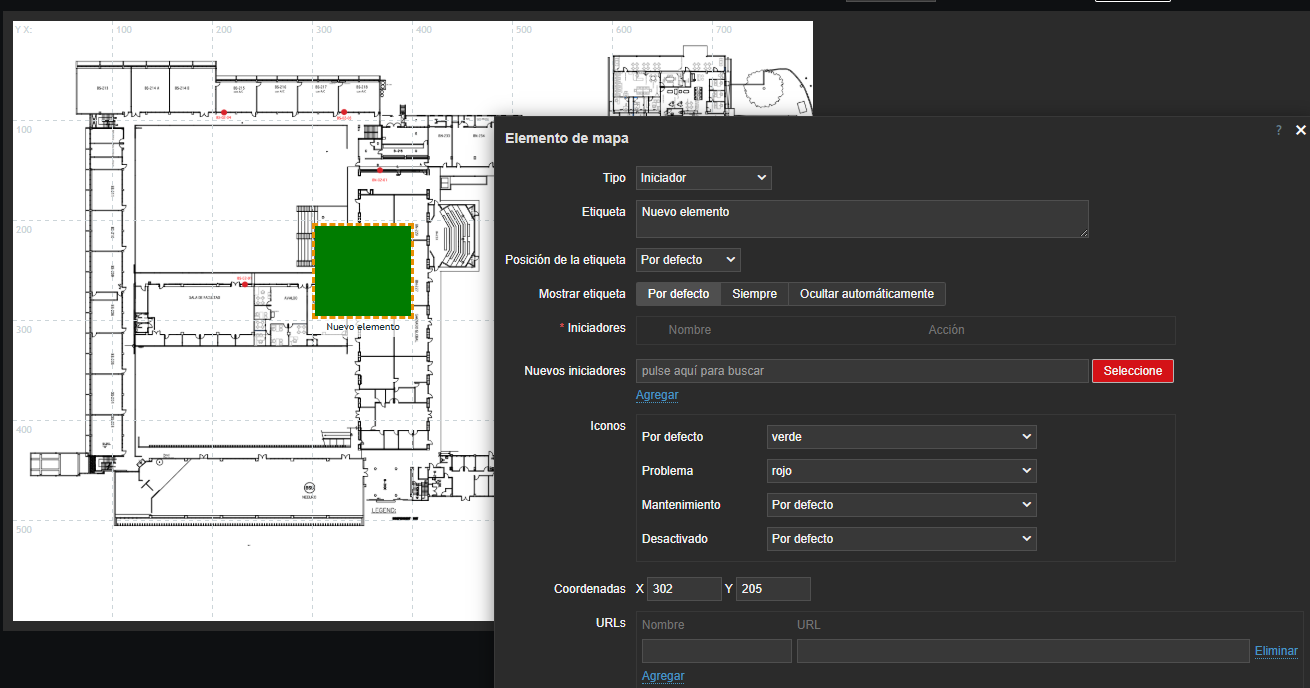

    imma try it for a second i can do something like this , and when a trigger fails it will change its form to "rojo" that is a red square i think that to change the shape the best is to add the icons by length and width
    Click image for larger version  Name:	image.png Views:	0 Size:	143.6 KB ID:	506318​

      Thank you for idea! Yes, I am considering this option, to use the figured areas of the premises as host icons, but this is for extreme cases.
