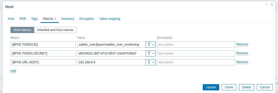

        This is how I configure PVE:
        • User group: monitoring
        • User: zabbix (member of monitoring group)
        • Permissions: monitoring group is assigned PVEAuditor role (path = /, propagation = true)
        • API token is created for zabbix user (expire = never, privilege separation = no)
        Then configure the Zabbix template according to the template instructions.
        Update: From the template instructions:
        • Copy the resulting Token ID and Secret into the host macros {$PVE.TOKEN.ID} and {$PVE.TOKEN.SECRET}.
        • Set the hostname or IP address of the Proxmox API VE host in the {$PVE.URL.HOST} macro. You can also change the API port in the {$PVE.URL.PORT} macro if necessary.

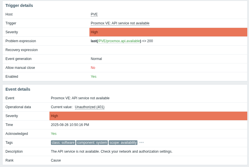

                I basically walked back through what you recommended. I can't get it to work. The API just keeps throwing 401's.
