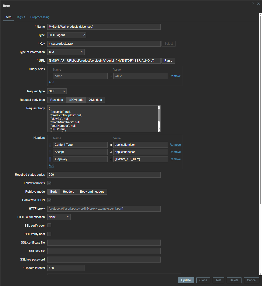

    I have been trying to use the SonicWall API to tell me about firewall and switch licenses, specifically when they will expire. I was able to test and get the API to give me an output; however, the part I’m stuck on is making it so host items are dynamically found within the SonicWall portal that I’m supporting. For instance, I am trying to match the host and API info via serial number.
    In the SonicWall integration, the serial number item is included, and I have been trying to utilize this in the inventory. However, the item I’m using does not seem to be grabbing {INVENTORY.SERIALNO_A}, even though it’s set to auto and is indeed a real serial number I see on the SonicWall portal.
    I have also tried JavaScript:
    {"data":[{"{#SERIAL}":"$VALUE"}]}
    as an LLD to give me a key. I’m not very strong in coding, so I may have done something wrong. However, the output keeps giving me "{#value}" instead of the serial number value.
    My main goal is to get this item working as it should. The only part I know is not working is the {INVENTORY.SERIALNO_A}.
    Any help would be appreciated, even a link to a similar situation.
