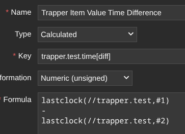

    I think you could try using a calculated item with the "lastclock" function.
Name:	Screenshot From 2025-08-30 10-38-45.png
    This item should store the timestamp difference between the last value of an item and its previous value. Then, a trigger can evaluate for an abnormal behavior.​
    Note that the interval of the calculated item can affect the time values.
    Perhaps a trigger with expression macros could create more meaningful events.

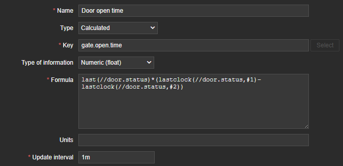

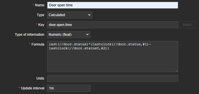

      I've modified your proposition creating this:

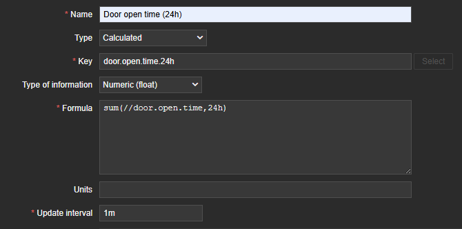

      I'm using last() function to filter only status "open". To sum up for how long that door was open in the last 24h i've created another calculated item:
      It won't be fully accurate yet (due to update intervals), but i'll give it few days to see if it works in any way.
