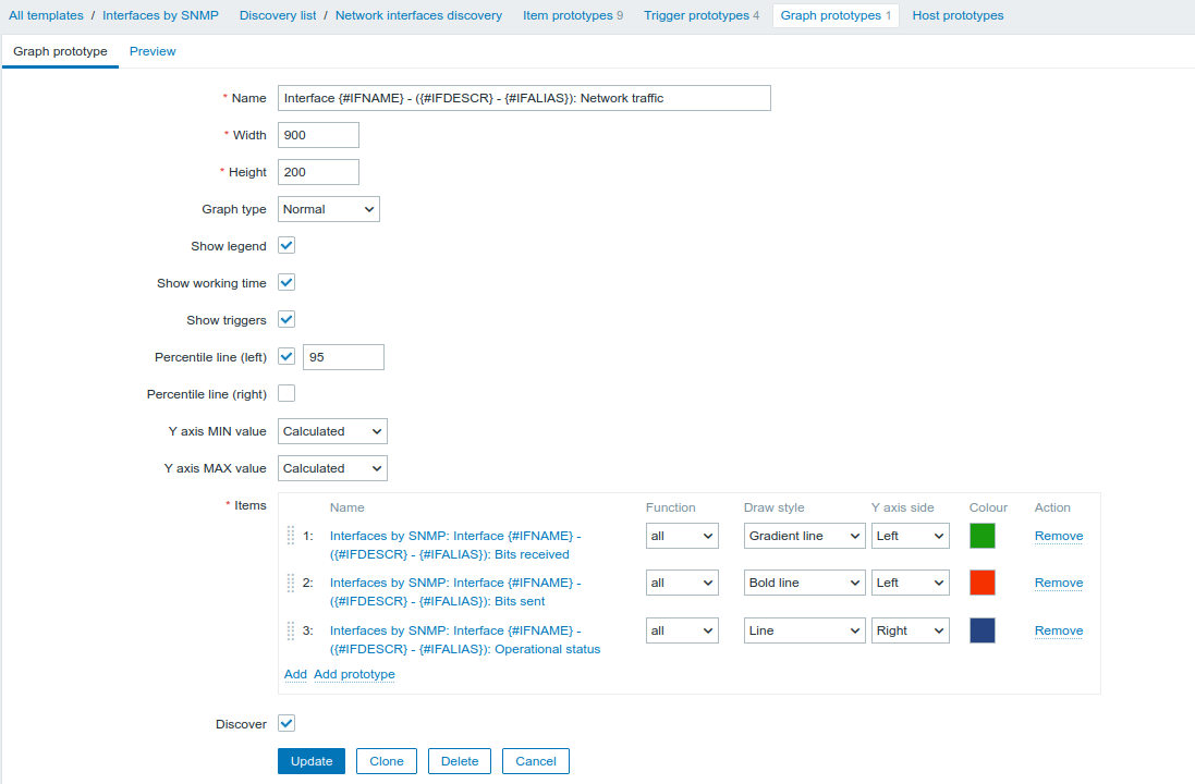

    For example, I added number 3 here:
    Note that I have set the Y-axis to "Right" because the units are a completely different scale to throughput items.
