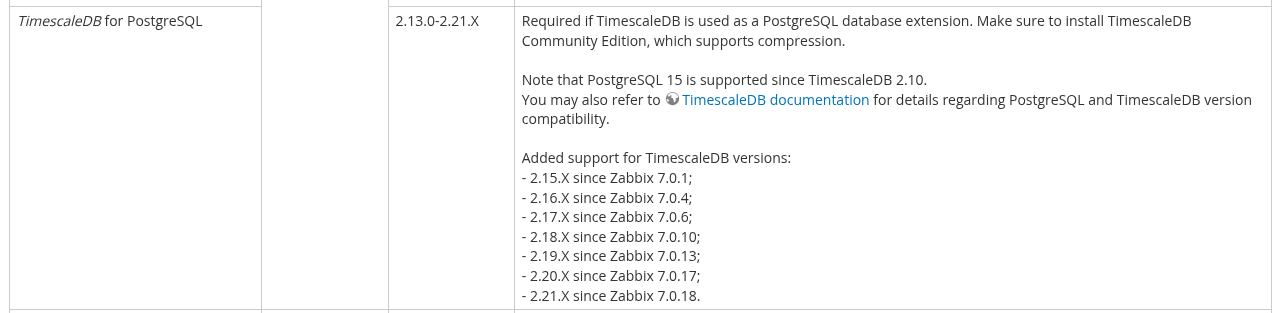

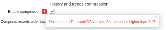

    On my side I have a timescaledb to a not supported version. It works mostly fine but I think compression is not enabled.
    it corresponds to the supported timescaledb for zabbix 7.0.8. Unfortunately I have version 2.18 installed. I don't know if we could downgrade version easily. By the way as mentionned here in my case I just have to update zabbix server.

      I have run unsupported TS version without any issues for quite some time. Same reasons as here, TS version comes earlier than Zabbix and unfortunately I have no option to delay some packages..
      Never had issues with compression.. .
