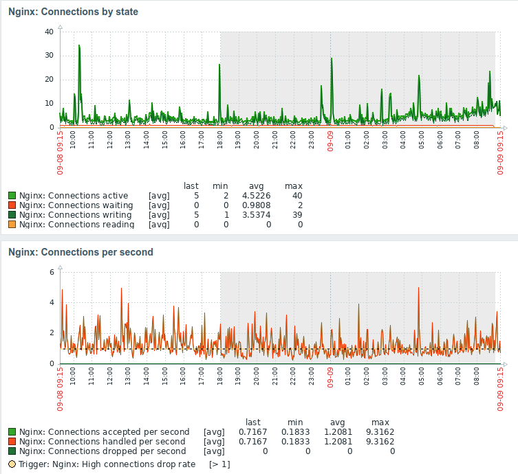

    As far as I can tell it's only the Zabbix metrics which seem to be affected.
    The web service continues to serve pages. Nginx metrics polled by the Zabbix server have no holes in:
    What would explain this odd behaviour? Is this a DNS issue?
