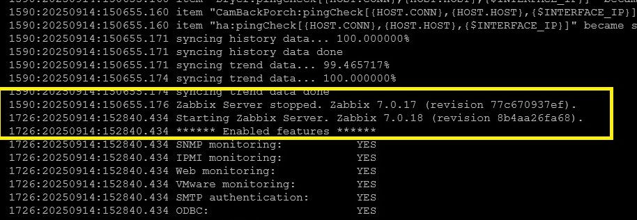

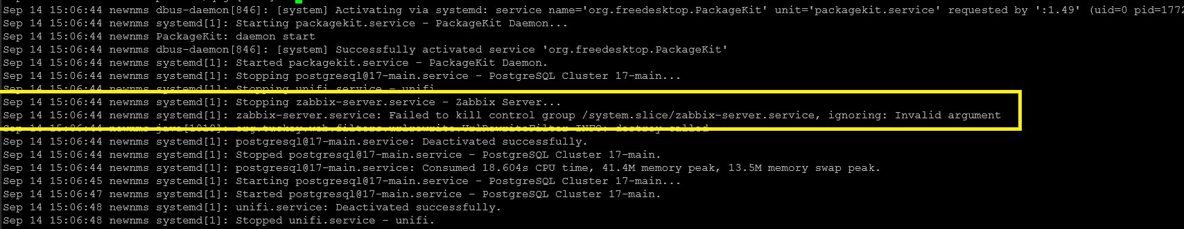

            Originally posted by cyber
            Have you ever looked into zabbix own log from that time ? I have seen cases, when history sync during shutdown takes ages... you can literally see it going 0.xx% per sec, as it writes that progress to log... And it may take 30-40 minutes... even more.
            Oddly enough it looks to me like it DID stop (2nd screen shot), but look (1st screen shot) what I found in the syslog.
            I have no idea what that means. Let me do a couple of reboots.

              I just did a reboot, and there is NOTHING in the syslog showing zabbix server stopped.
              However, with zabbix running I did a systemctl stop zabbix-server, and that invalid argument is in the result (and it did stop). So I think that's wrong, not sure what but maybe something in the distro incompatible with this systemd, but it does not at least by itself keep it from stopping.
              But sometimes it won't stop. Those of you with it also failing, hunt around next time, see if you can find clues. It sounds like it's infrequent but fairly widespread given the responses (and how little traffic you get here normally).
