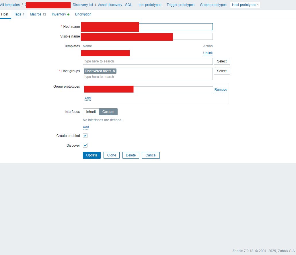

      i dont happen to find this option, is this something available on 7.2 or 7.4 version ?
      Click image for larger version  Name:	image.png Views:	1 Size:	36.0 KB ID:	507545
        different discoveries here.. I think I was referring to network discovery and related actions.

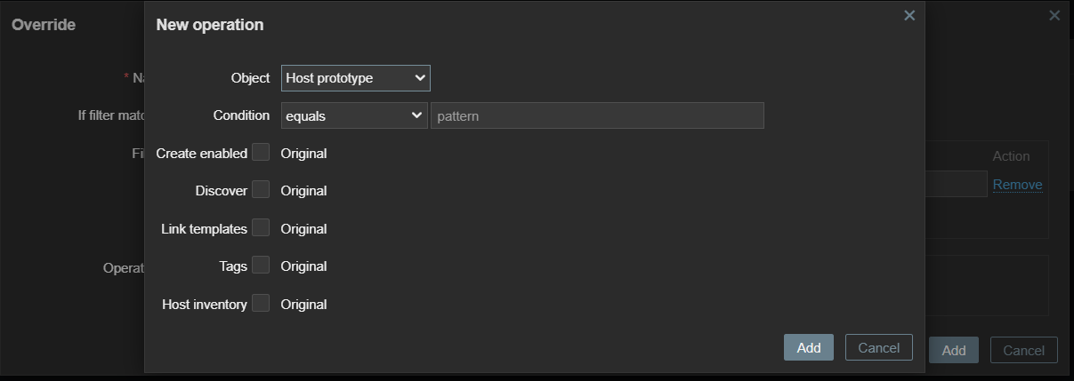

        But there is "create enabled/disabled" in overrides of discovery rule... TBH, I have not used it much ...

          ok i was able to find that part to, but the naming "create enabled" suggest to me that the enabled/disabled state is applied only when the host is created and not when it exists already, or am i wrong ?
          i might be giving it a try though, thanks for sharing
