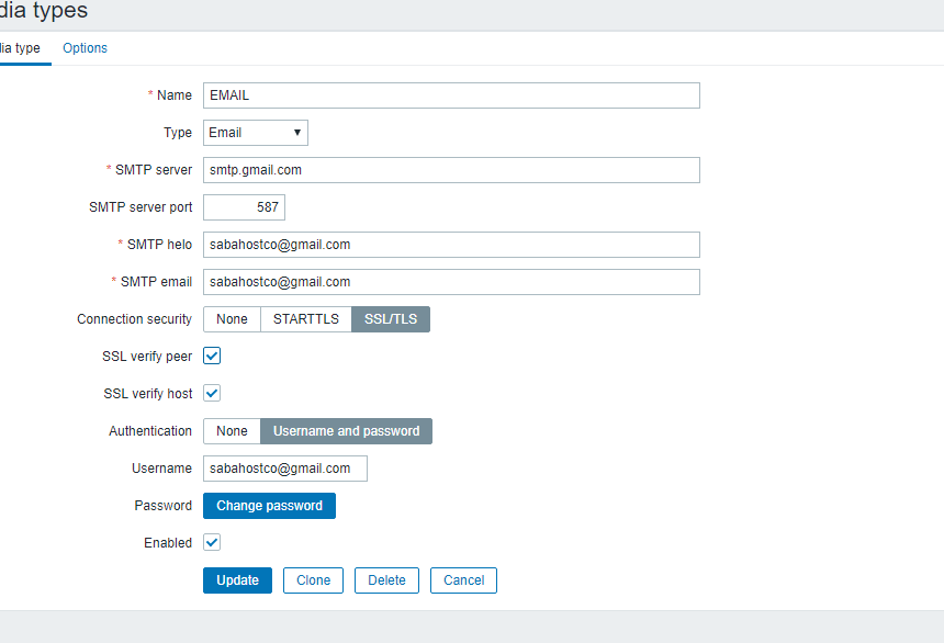

        Hello dear,,, I Have the same problem. so i can send mail via cli but zabbix can not send mail to admin...I mean when i send mail via cli, its sending from gmail account but zabbix can not do this..everything i checked is ok... this is my EMAIL configuration :
        I had installed postfix on zabbix server and configured that for realying to Gmail... it works fine and i can send mail via command line.
        it seems that i've missed some configuration,,, any idea?
        also I'm using zabbix server V4.0 and i checked other port and features like port 465 and 25.
        can somebody help me
        kind regards

          Looks like the problem is in the connection between zabbix server and gmail server, hard to say what the exact problem would be with so little information.
          tellpopeyes
