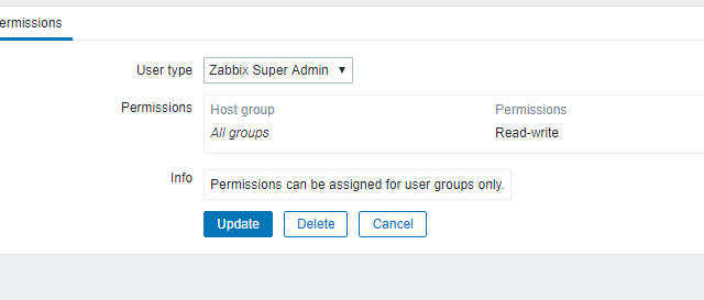

    Permissions
    Hi, I have just setup Zabbix and had the same issue.
    it was a permission issue inside Zabbix GUI.
    Make sure your users or media types permissions are set to read write for ALL host groups or it won't work

      I am confused. I have a host group called 'disabled' as well as 'guest' The point of these groups as I understand it is so they do NOT have access. Do I need to give them all read/write? and if so what is the mechanism that I can use to prevent them from having access to the system?
