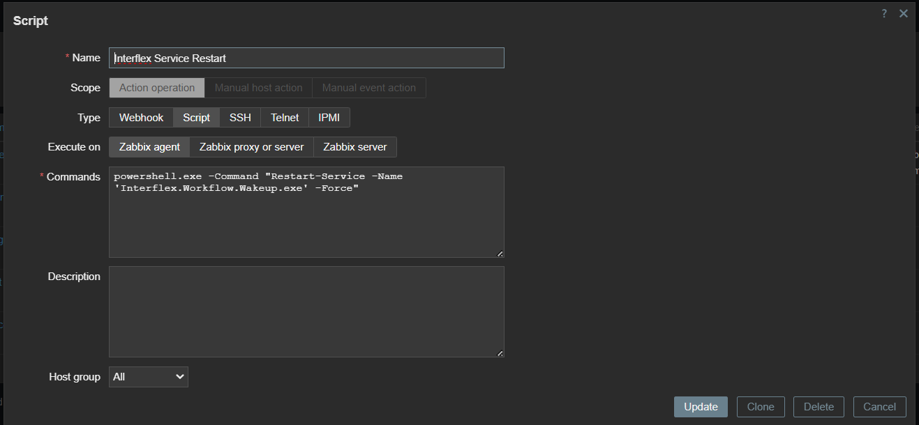

    To test, I created a manual host action (Alerts → Scripts → Scope: Manual host action) with:
    powershell.exe -Command "Restart-Service -Name 'Interflex.Workflow.Wakeup.exe' -Force"

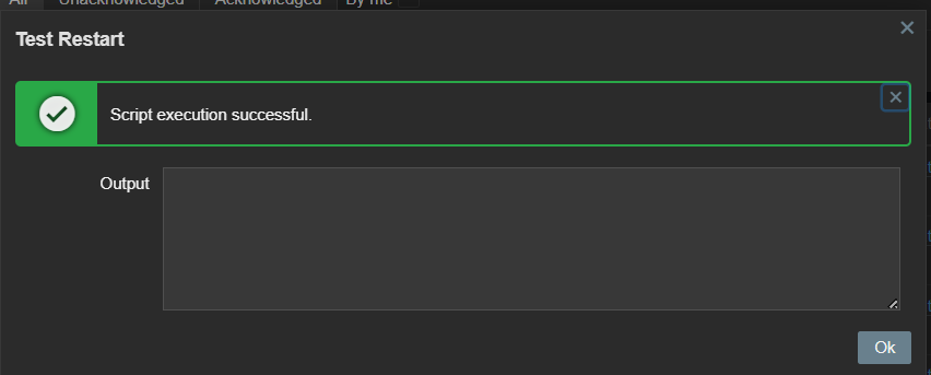

    When I manually execute this from the host’s frontend:
    It works perfectly.
    The service restarts, no errors.

    Using the same exact script inside an Action → Operations (trigger-based automatic action), Zabbix shows the following error:
    Unknown metric system.run
