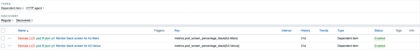

    I basically want to create some graphs for "pod_screen_percentage_black" and also triggers when over 60 for 20mins.
    I'm created the Discovery rule and LLD macros such as
    {#NAME}
    for
    $.name
    plus the item prototype which is a dependant item with a key of
    metrics.pod_screen_percentage_black[{#NAME}]
    In the preprocessing I am using a JSONPath and the parameters are set to text as numerical won't work:
    $[?(@.name == '{#NAME}')].metrics.pod_screen_percentage_black

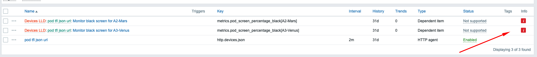

    If I change to numerical (unsigned) in the item protocol section I get:
    Value of type "string" is not suitable for value type "Numeric (unsigned)". Value "[47]"

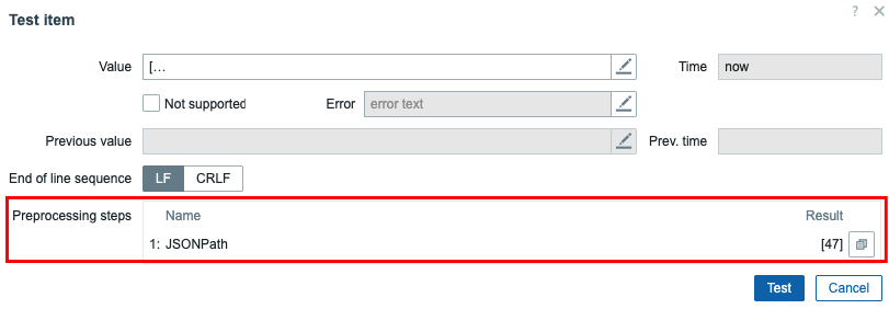

    When I test it though is looks ok:

    • 4997
    [47] is not excactly 47, what would suit "intger" or "unsigned"
    you can also add "$[?(@.name == '{#NAME}')].metrics.pod_screen_percentage_black.first()"
    • G0nz0uk
      G0nz0uk commented
      So is that Zabbix adding the [ ] around the number making it more of a text reply then?
    • 4997
    Zabbix shows you everything as requested...
    look on examples...
    It is all something objects vs arrays ... All of it usually makes my head ache..
    • G0nz0uk
      • Apr 2021
      • 72
      Thanks for the URL and example .first() as this worked as numeric (unsigned)
