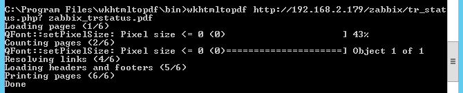

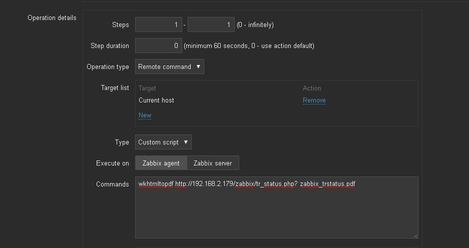

    Can anyone figure out error on this command?
    I try to remote command using the operation action on zabbix. Then, when action happened, it state the operation successfully done but it failed to execute the commands. Here, I attached for further understanding.
    Thanks.

    Do you have remote commands enabled on the agent?
    EnableRemoteCommands=1

      Hi Sancho,
      I have enable it but still the remote commands failed.
      Any idea?

        And have you restarted the agent service after modifying the settings?
        Check the zabbix_agentd.log, if you do not see anything go up DebugLevel = 4 in zabbix_agentd.conf to see if it shows anything that can help.
