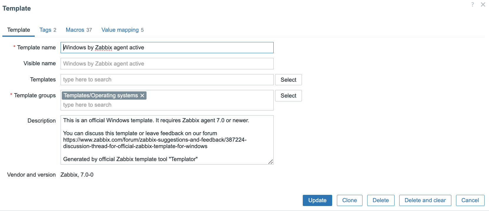

              Hi there,
              I think several solutions could work and this issue was driving me nut... but I think I found my problem (please confirm what you can find on your end)
              My "Windows by Zabbix agent active" template doesn't have any "sub template" attached, compared to "Windows by Zabbix agent" that has plenty.
              I was editing the macro in template "Windows services by Zabbix agent active" but if this one is not linked, it can not work.
              Can somebody tell me what I should find in there? Thanks in advance.
              PS: the main template has macros, probably from before the inheritance issue (if there is one of course)
              PS2: my installation is at least 6 ears, might legacy templates showing me the wrong things

              • kyus
                • Feb 2024
                • 203
                I'm not sure about what you meant, but the service discovery exists in the Windows by Zabbix agent template (active or not), and those templates don't have any "sub templates" (at least not in the version that I have).
                Since you've mentioned that it is an older installation, I would suggest that you take a look at the problematic hosts "Macros" tab. It is possible that the {$SERVICE.NAME.NOT_MATCHES} macro was edited in the host configuration and, therefore, it doesn't get updated when you edit this macro in the template configuration.
                • EHRETic
                  • Jan 2021
                  • 45
                  Well, at the end of the day, I was putting my macro at the wrong place (Sooorrryyyy)
                  I'll explain : probably in the past, there was some hierarchy in the templates:
                  Windows by Zabbix agent active -->
                  • Windows services by Zabbix agent active
                  • Windows network by Zabbix agent active
                  • etc...
                  And I was putting my macro in the service template, without realizing that the inheritance was not there anymore (I still have that inheritance with the non active template). I think on update probably get rid of that inheritance.
                  After I put the regex in the macros from the main template, it was working fine.
                  The regex that works for me is :
                  ^(?:RemoteRegistry|MMCSS|gupdate|SysmonLog|clr_opt imization_v.+|sppsvc|gpsvc|Pml Driver HPZ12|Net Driver HPZ12|MapsBroker|IntelAudioService|Intel\(R\) TPM Provisioning Service|dbupdate|DoSvc|CDPUserSvc_.+|WpnUserServic e_.+|OneSyncSvc_.+|WbioSrvc|BITS|StateRepository|t iledatamodelsvc|GISvc|ShellHWDetection|TrustedInst aller|TabletInputService|CDPSvc|wuauserv|edgeupdat e|cbdhsvc_.+|webthreatdefusersvc_.+|EHRETic-Services-Behind|AppXSvc|brave|camsvc|GoogleUpdater.+)$
