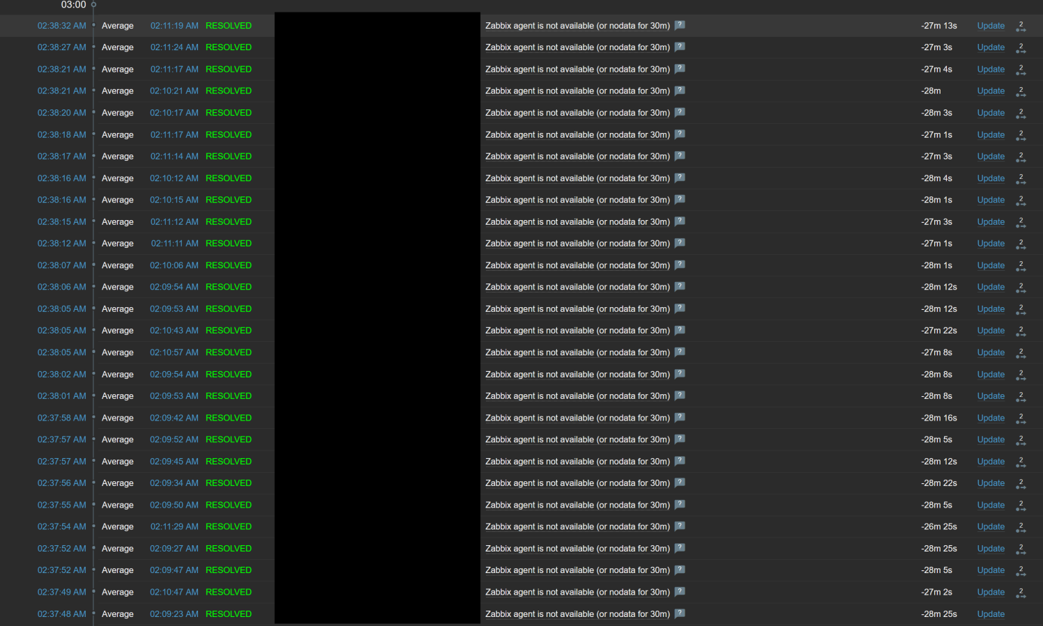

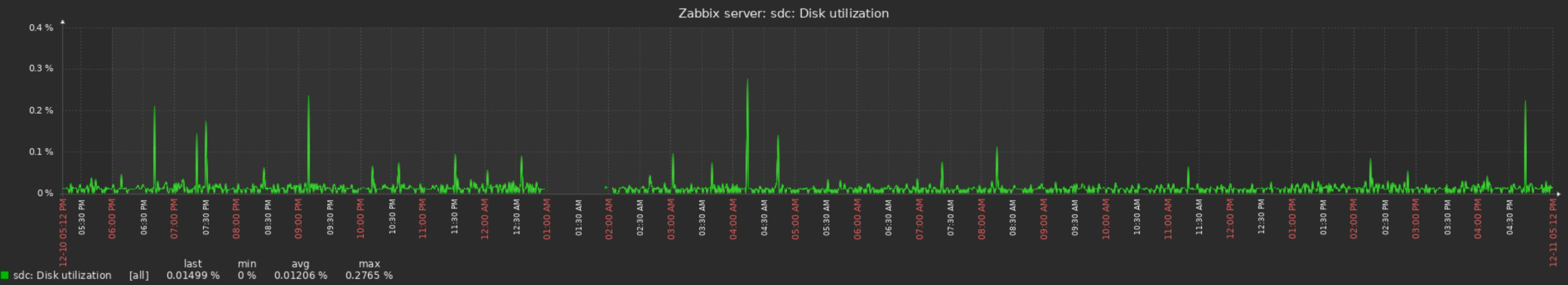

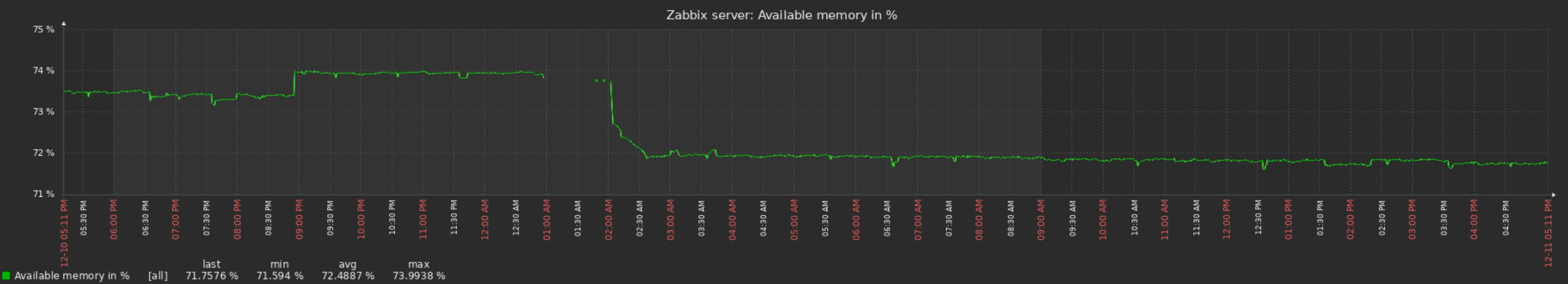

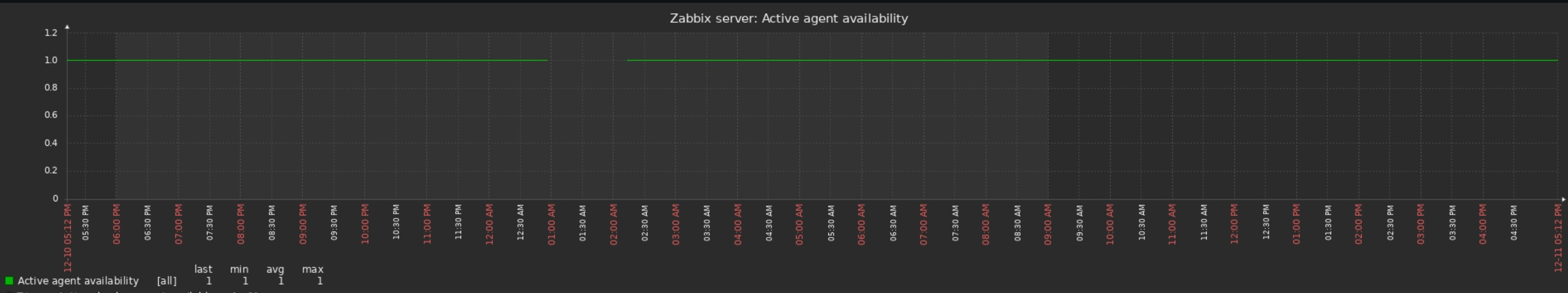

    I'm running into an issue where all of our servers in production fire alerts for Zabbix agent is not available (or nodata for 30m) irregularly at night. Thing is, none of the servers or agents appear to be down, and the active zabbix server isn't really experiencing any issues. Looking at the the graphs, I do see drops when this happens (Usually brief, last one as an hour since it looks like it happened twice). Which makes sense because the agents can't talk to the server.
    I took at look at the Zabbix server logs around that period, but nothing is standing out as an issue. The zabbix agent logs show some sporadic failing to connect errors, but these don't always line up. I have checked our database backups and VM Snapshots. The database backups start roughly 90 minutes before the issue and generally finish an hour after it occurs, which the VM snaps are longer, but start around 9 PM, so it doesn't seem like it's responsible. I'm also not seeing any memory, CPU, etc spikes on the database or the servers before it happens. There's one when they start responding again of course.
