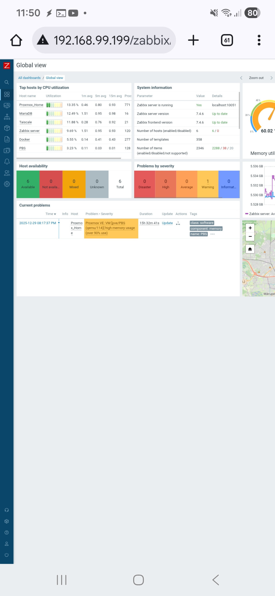

    Hi everyone,
    I am struggling with the Zabbix API (v7.0/7.4). I am trying to build a bash script that fetches only the currently active problems as seen in the Zabbix Dashboard "Current problems" widget.
    In my Zabbix Frontend (Global View), I only see one active warning (High memory usage). However, my API script returns nine results, including "Not running" and "Restarted" messages that are NOT visible in my current dashboard view.

    Observations:
    ​Some "Not running" messages have acknowledged: "1", but they still show up in the API result.
    ​suppressed is returning null (probably because I am using trigger.get instead of problem.get).
    ​My Dashboard is clean, but the API seems to ignore the filters that make the Dashboard "clean".

    My Question:
    What do I need to change in my API request to get exactly and only the same active problems that are visible in the "Current problems" dashboard widget? Should I switch to problem.get, and if so, how do I correctly filter for "unsuppressed" and "globally visible" issues?

    You must match filters in Dashboard.
    You can have some ideas how zabbix combine data if you enable frontend debugging (Users/User Groups set Debug mode = Enable for user group)
    Debug button should appear at the bottom of the page.
    Click on button and debug output for page .api calls - in my environment it uses both problem.get and trigger.get. and some more.
    • Ipod86
      • Dec 2025
      Thanks for your reply, that solved it together with ChatGPT.
