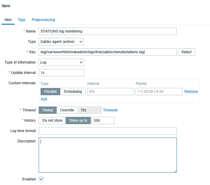

    The scenario is as follows:
    Zabbix 7.4.5 is monitoring a log file on an Ubuntu server, where several remote clients write a status message every 60 seconds.
    The status messages are something like: "STATION xxx - OK", or "STATION xxx - OFFLINE".
    So the log monitoring item is like this:

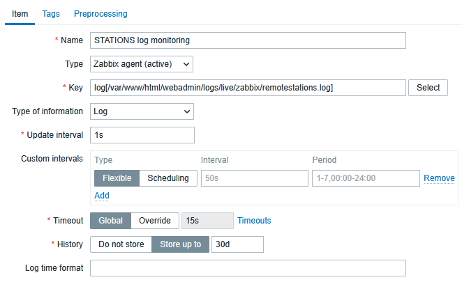

    I'm trying to create a trigger that fires if a station is OFFLINE for 3 (or more) consecutive minutes. So the trigger is like this:
    What's wrong with this?

    I think I figured this out.
    The problem is that this way the trigger cannot discriminate the third "OFFSITE" occurrence from the same station. It would fire if three consecutive "OFFSITE" status messages appeared, regardless of the sending station, which is unlikely to happen - and it is not what I want anyway.
      • 4993
      You have multiple endpoints writing there... so using count(..#3,"regexp","OFFLINE")=3 does not mean, it is all the same endpoint... You can have 3 different endpoints there writing that they are offline... #3 is "last 3 checks"... your item is with interval 1s, so within last 3 sec basically...
      additionally to that, your recovery expression is pretty much useless here... look it up, when and how recovery expressions are actually used.. (it is an additional condition, that has to be true AFTER original expression has been calculated to false)...
      • Moebius
        • Dec 2022
        • 43
        Yes, that's what I have figured out.
        I was trying to build a trigger that would fire if the last 3 entries from the same endpoint are all "OFFLINE". It seems that in my case there are no ways to have the trigger do what I want it to do, unfortunately.
        There are about 150 endpoints that write one status line each every minute. And yes, the recovery expression works fine in the original setup (the one using "find", with the trigger that fires at first OFFLINE occurrence).
        I was also wondering if #3 means "last 3 log file checks" or "last 3 log file entries". You state it refers to the checks to the item. Thank you for making this clear to me!
          • 4993
          #3 is last 3 values... are they collected in one run or multiple ones... does not really matter.
          Maybe my example was worded a bit badly... considering 1 entry per sec... Which still can happen, but if you have 150 endpoints writing there once a minute... you probably get more than 3 per check ... and not 3 times from same endpoint...
