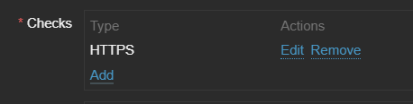

    Discovery allows to define extra checks.

    and add additional disocvery action based on that result...

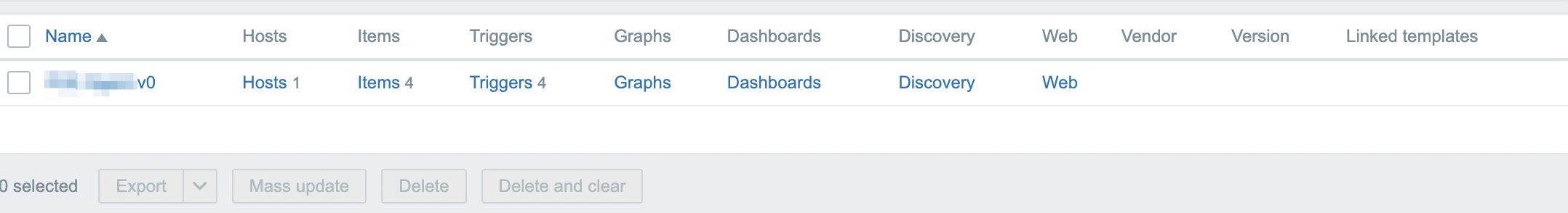

      I think I'm confusing myself on getting this discovery working. So I have the template working just great if I assign to a host device that is running http://{HOST.IP}/v0/metrics.json
      As you can see on the template below I have no discovery yet:

ID:	510414I want to get it to to discover http://{HOST.IP}/pod/v0/metrics.json first then if it finds it run through the items of not then skip this template on that host.
      What would the discovery section look like for this please?
      Looking at your screenshot I can't tell how you get to that 'check' section.
        Eeeeh... My screenshot is from network discovery... Not from discovery section of template... So disregard my answer...
