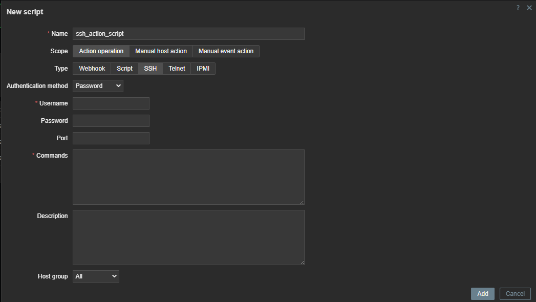

      Zabbix uses "actions" which act when trigger is fired.
      To execute script - you must first create Action Operation as SSH under Alerts->Scripts

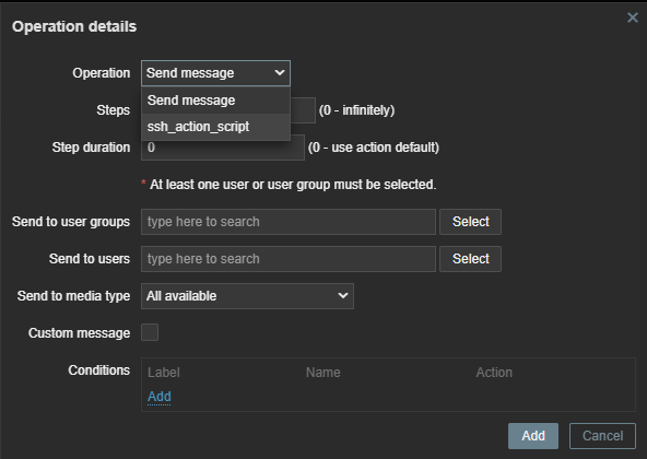

      Then when you will create action you can choose to execute this Action Operation instead of Sending message
