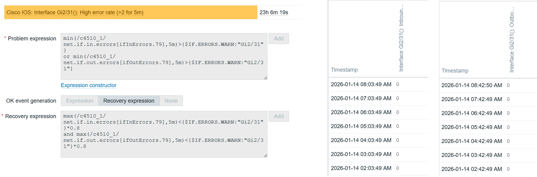

    Hello, how should recovery trigger IOS High Error rate ?
    {$IF.ERRORS.WARN} = 2
    Last data Inbound and Outbound errors for last 5 hours = 0 (on screenshot) And its never recovered
    Click image for larger version  Name:	zbx_ios_trig.png Views:	0 Size:	93.4 KB ID:	510354

    Hello
    I was wrong that the marco multiplication won't work, sorry about that. However, as your screenshot shows, data for in and out errors arrives just every hour in very different time frames, yet for the 'and' condition in the recovery to work the data needs to arrive more or less in the same time (as it is evaluated just in the 5m time frame).

      Thanks, i understanded misconfig

    Hello
    Multiplying user macro by 0.8 won't work, a separate macro for the resolving error threshold level should be used instead.

      Hello
