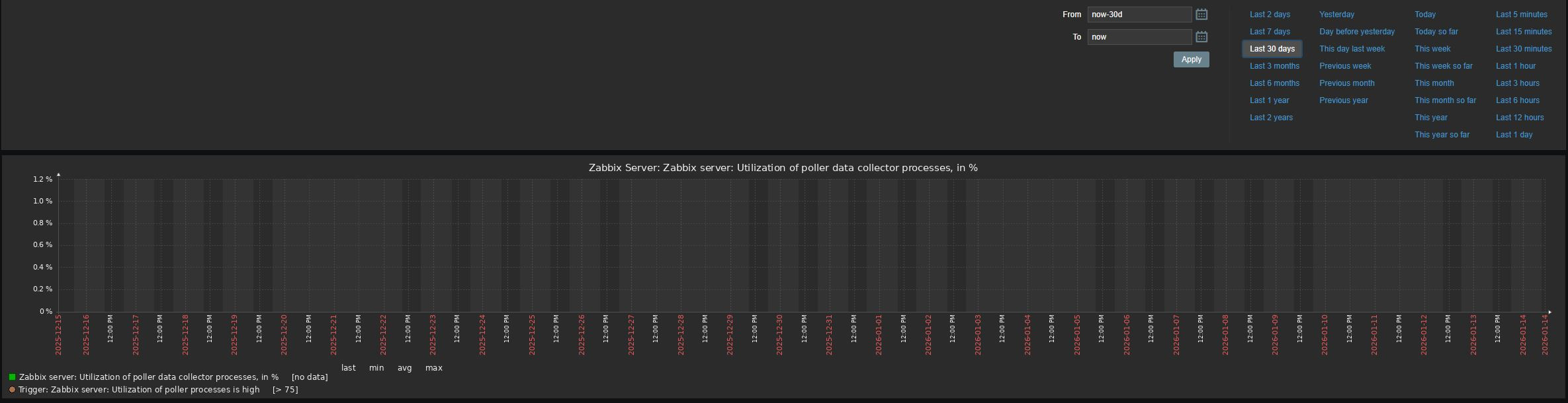

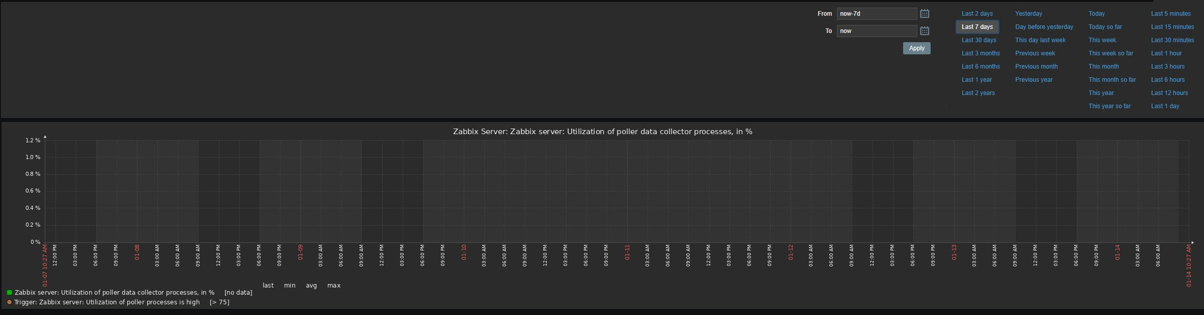

    Sine then I'm suffering from a weird behavior where I cant see that historical data collected since why I'm executing more the 4days of history in one query.
    Please refer to the attach picture.

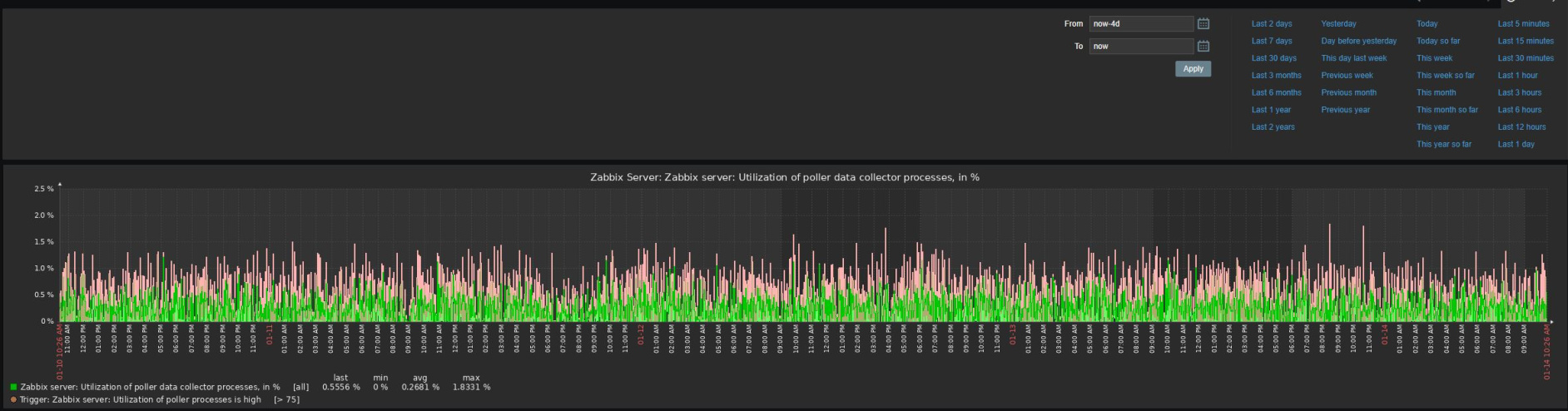

    When querying "last 4days" you can see that I have the graph full of data and when querying "last 7days" the graph appear to be empty.

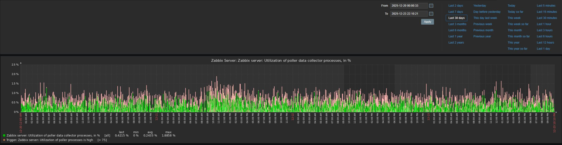

    Same happening when querying "last 30days" but you can see when I zooming in to 20-23 days (in the last 30) the data is there.

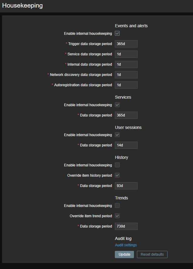

    * I have added the HouseKeeping configuration (attached pic)

    When attempting to display a graph for a short period the data might be pulled from history, for a longer period data is taken from trends, therefore it seems that the trends table is not enough populated for this item, which could be because of the partitioning settings related to this table.

      It seems that the trend tables are empty.
      But why for 7days the zabbix try to query the trend table instead of the history one?
      How can I solve that?
      Changing the house keeping? partitioning?
      Or just wait for 3month too pass until the trends tables will be fill with the current config?
        using history vs trends, it depends on the amount of data it has to present. Full data for 30 days will never fit your screen, so it is drawn from trends.. if you zoom in to 1-2 days, your graph is redrawn fro history data.
        If your trends are missing, then no waiting will cure it.. You need to find a reason, why it is not writing trends (it is done actually during history saving, not after X days). It is hard to say right now, what can be wrong here, some DB triggers missing or table permissions etc...Start from DB and server logs, maybe there are some hints...
