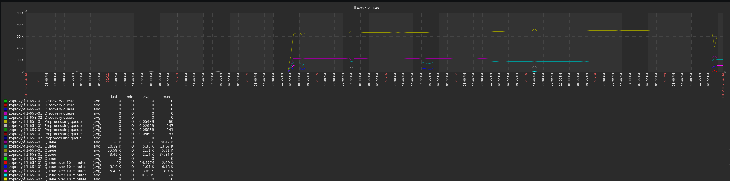

    After updating templates and configuration files on monitored nodes, I figured out that proxy queue over 10 minutes grown, but only for 2 proxies(both in one proxy group).

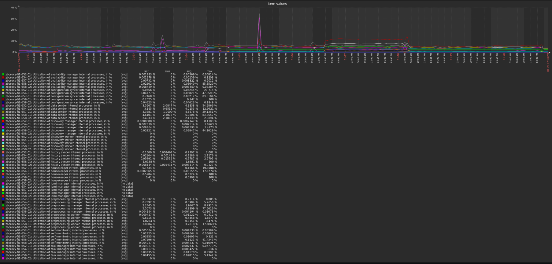

ID:	510535I have done so many tries to fix this( increasing trappers, dbsyncers, processors etc), but this did not solve the problem. I even tried to send data manually by hands making dump and sending data to server using zabbix_send (sound silly, I know ). My graphs shows, that my proxy does not load at all:

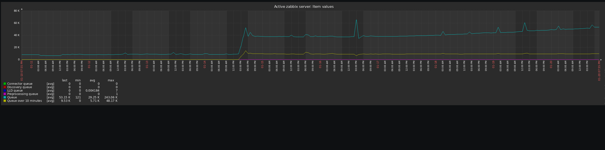

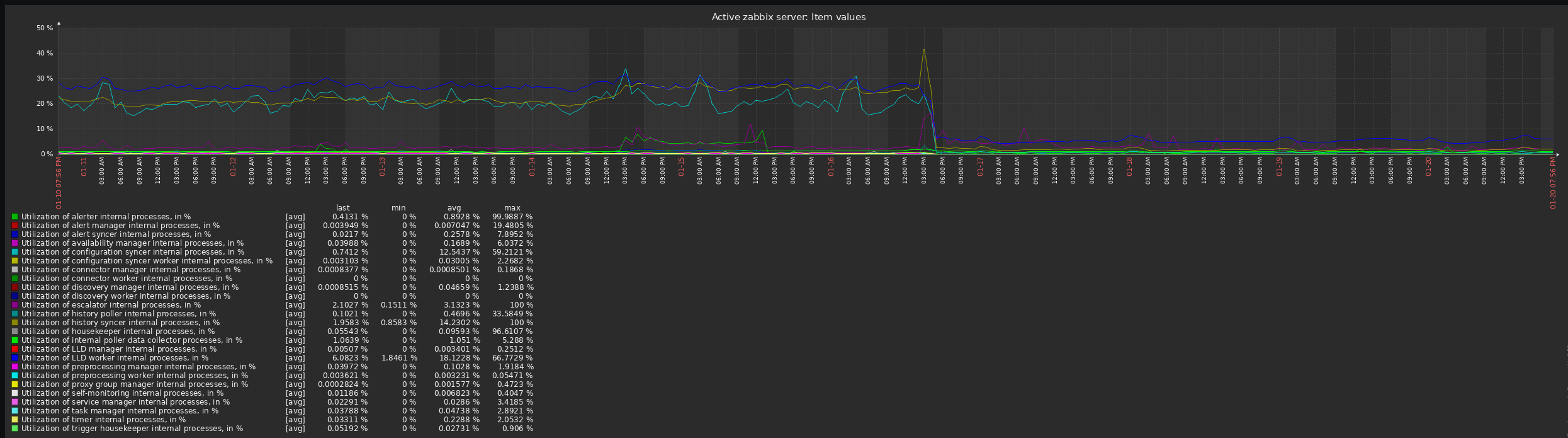

    My Server graphs:
ID:	510538​Click image for larger version
ID:	510539​My zabbix server is 7.0.19 version, version of zabbix proxies I have problem with is 7.0.22. I'm begging for help, tired of struggling with this
