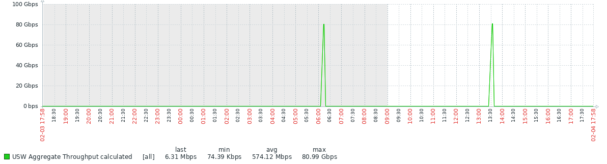

    I am having a problem with traffic counters that are probably going back to zero when "something" occurs on the switch, perhaps a loss of connectivity with the controller.
    "tx_bytes": 2671104751379,
    "rx_bytes": 490292731426,
    "bytes": 3161397482805,
    This results in silly spikes of traffic in the graphs:

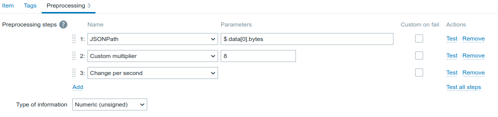

    Item configuration:
    Yeah, I can do an "in range" pre-proc step, but the threshold is un-knowable. I have gone all the way down to 4Gbps and still get spurious spikes anywhere from 500Mbps up.

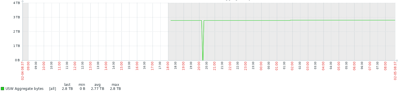

    I duplicated the item without the change-per-second step and can see this is the real issue:
    I am guessing this is an issue with the API returning 0 randomly. So I will add my range check step before the simple-change and that should eliminate the spurious spikes.
