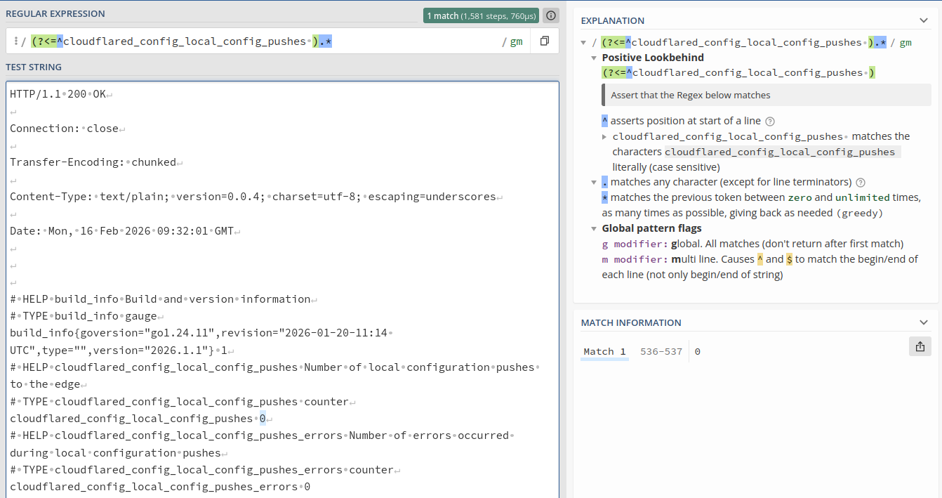

    (?<=^cloudflared_config_local_config_pushes ).*
    You can see it matches the value 0:
    Click image for larger version  Name:	image.png Views:	0 Size:	192.1 KB ID:	511137

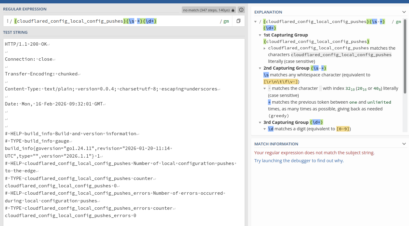

    (cloudflared_config_local_config_pushes_errors)(\s +)(\d+)
    Capture group \3 (Output)
    I have no idea why lookbehind does not work
    • troffasky
      • Jul 2008
      • 639
      Thanks for looking at this, but that also doesn't work in Zabbix, with the same error [I have tried with and without ^]
      Preprocessing failed for: HTTP/1.1 200 OK..Connection: close..Transfer-Encoding: chunked..Content-Type: text/plain; version...
      1. Failed: cannot perform regular expression "(^cloudflared_config_local_config_pushes)(\s +)(\d+)" match for value of type "none": pattern does not match

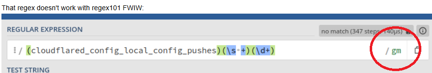

      That regex doesn't work with regex101 FWIW:
      • guntis_liepins
        • Oct 2025
        • 61
        Zabbix run regexp without gm modifier. Disable them in regex101.
