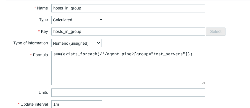

      This is a bit tricky question and solution I offer may be not optimal, but since nobody suggest anything better here will my 5 cents.
      1. we need some item common in host group which every host in this group has . I will use agent.ping in this example
      Make calculated item
      name hosts_in_group
      type Calculated
      key hosts_in_group
      Type of information integer
      formula sum(exists_foreach(/*/agent.ping?[group="test_servers"]))
      This work this way - exists_foreach Returns '1' for each enabled item , item selector - selects whole host group , then sum this value.
      As each host must return 1 if agent.ping is enabled, for each host then sum of all items will be equalt to a count of hosts in host group.

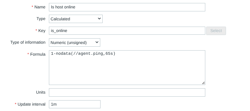

      2. we need item which returns 1 or 0 in each monitoring cycle, which would indicate if host are up or down.
      agent.ping does not fit out purpose as it returns 1 - available, but does not return data if not available.
      so we for every host create item is_online
      name Is host online
      type Calculated
      key is_online
      type of information Integer
      formula 1-nodata(//agent.ping,60s)
      Nodata will return 1 if host have not received successful agent.ping for one minute. So his item will return 0 if host is offline , but will return 1 if host is online.

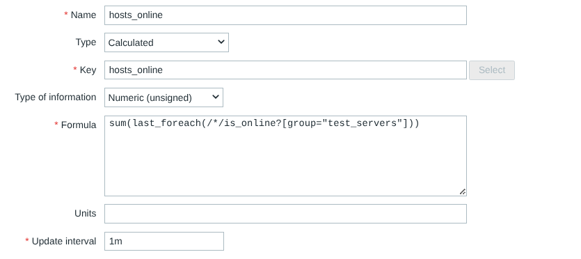

      3. Now we create function which will show us ho many hosts are online
      name hosts_online
      type Calculated
      key hosts_online
      type of information integer
      formula sum(last_foreach(/*/is_online?[group="test_servers"]))
      This function will get last value for each is_online item in group test_servers then sum it together.
      As online hosts count as 1 , offline hosts as 0 this item will return integer host many hosts are online

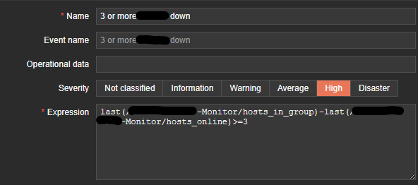

      Now we can create trigger which will trigger when more than three hosts are offline (I created virtual host tt which hold two items hosts_in_group and hosts_online and created problem there )

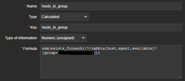

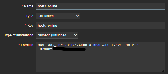

        Would I be able to use zabbix[host,agent,available] instead of agent.ping?
        From what I've found agent.ping returns no data in case of unavailability, whereas zabbix[host,agent,available] returns a 0
        So I wouldn't need step 2 and can replace 'is_online?' in step 3 with 'zabbix[host,agent,available]?'
        Correct?
        Edit: Also to make this more difficult I have 3 host groups so this needs to work if 3 or more hosts are down in each group
        2nd Edit: SOLVED: Created a host per group with the items - 'hosts_in_group' &' hosts_online' and the trigger. Each other host has the 'Is host online' item created via their template.

            Update -
            Using agent.ping was causing some false alarms so I replaced "agent.ping" and "is_online" in the items 'hosts_in_group' and 'hosts_online' with "zabbix[host,agent,available]"
            Also deleted the 'Is host online' item from the template
            So I have a host in each group with the below items -
            And this trigger -
            ​​​​Click image for larger version
