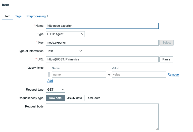

      Thanks I'll check those out. I did find https://www.zabbix.com/documentation...pes/prometheus
      I got this far before posting and got lost with what to do here

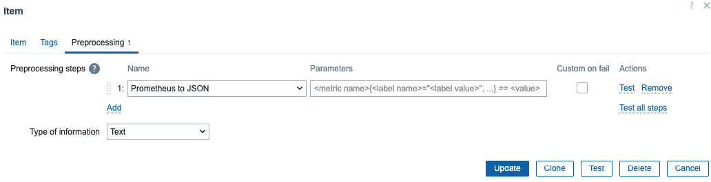

      And Pre-processing

          Usually I would go for:
          1. HTTP Item collecting all the metrics of an endpoint (this will be the master item), basically the item that you (but without any preprocessing).
          2. Then you create a Dependent Discovery Rule with the "Prometheus to JSON" preprocessing and also some LLD macros (can't really help here since i don't know what is displayed by prometheus) to create your items later on; you can also create filters if needed.
          3. Now you can create Dependent Item Prototypes in your newly created Dependent Discovery Rule. Those Dependent Item Prototypes will need the Prometheus Pattern preprocessing, and it is here that you will use your LLD macros.
          It's pretty confusing at first, so I'll try to give you an example of what I've setup to get some PostgreSQL metrics:
          Item configuration:
          Name: Get PostgreSQL exporter metrics
          HTTP Item [B]without preprocessing[/B] (very important)
          Dependent Discovery rule:
          Name: PG stat user tables discovery
          Type: Dependent Item
          Master Item: Get PostgreSQL exporter metrics
          Preprocessing: Prometheus to JSON -> pg_stat_user_tables_n_tup_del (this is the part of the metrics that contains values that I will use for LLD macros)
          LLD Macros:
               - {#DATNAME}          -> $.labels.datname
               - {#RELNAME}          -> $.labels.relname
               - {#SCHEMANAME}  -> $.labels.schemaname
          Filters: {#DATNAME} -> matches -> {$DATNAME.MATCHES}
          Dependent Item Prototype:
          Name: Rows deleted on database: {#DATNAME}
          Key: pg.stat_user_tables_n_tup_del["{#DATNAME}"]
          Preprocessing:
               - Prometheus Pattern -> pg_stat_user_tables_n_tup_del{datname="{#DATNAME}"} -> sum
               - ( You may want to use Simple Change or Change per second in some cases. This will depend whether it is a counter or gauge, but basically, counter -> change per second (to get the rate); gauge -> no preprocessing, or in some cases simple change)
