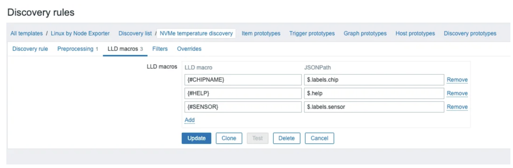

    and the LLD too:
    Then there is the item section and I'm a little lost.
    Any help to get me started would be most welcome. I'm not sure if using the discovery method is overkill and an area I've not tried before and should just use items.

    Definitely go for discovery. Use node_hwmon_temp_celsius{chip=~ ".*"} instead of node_hwmon_temp_celsius{chip="nvme_nvme0",sensor=~ ".*"} as some other servers may have several instances of chips.
    But you are on right track - you just defined item prototypes. Each item prototype is dependent item , dependent"Get node_exporter data" . You can spy examples from other items.
