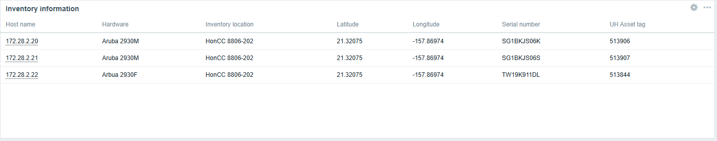

        Here are some screen shots from my zabbix setup
        This is the display from the top host widget

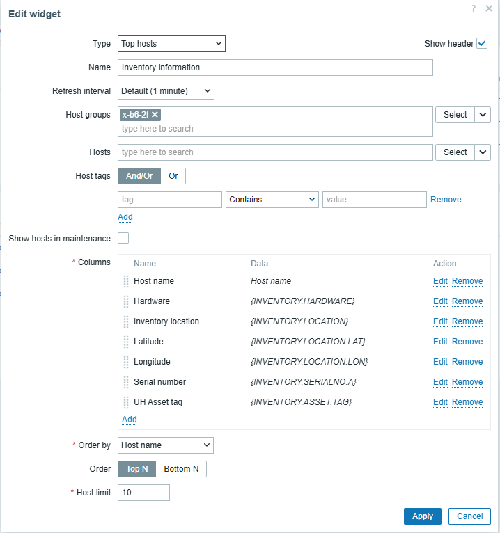

        Editing the top host widget

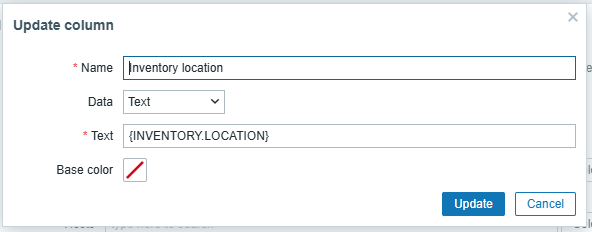

        Editing the column Inventory location
        For the Data dropdown there are three possible options which are Item value, Host name and Text. In most cases one uses the Item value option to get data from a device using what the device's template is setup (like IP address for example). If you are using the {INVENTORY.x} macro you need to use the Text option in that Data dropdown.
        Hope this help things.

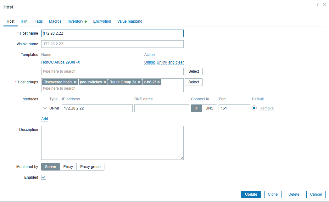

          Also doing a couple of screen shot of one of these switches.

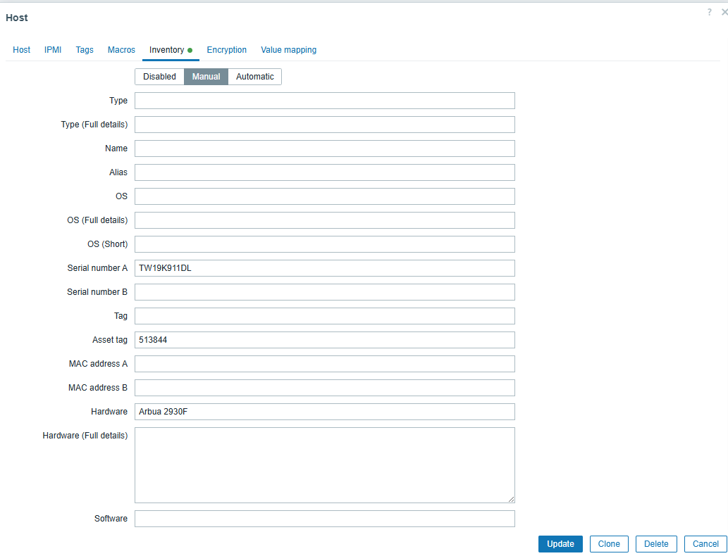

          If one clicks on the Inventory link (with the green dot to the right of it, which means you have data there) you will get this screen below:
