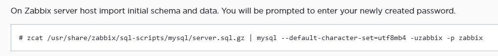

    The above steps start off with mysql -uroot -p and password
    I assume that since the instructions are telling me to run the following commands, that I'm using password as the password? or should I be setting my own password here?
    When I try to set my own password, I run into an error for this command:
    I entered in the password from the start of section d. commands for mysql and I get this error.
    So I'm not sure why this is the case. Maybe to me, its not clear that I am supposed to set a new password or use a default password for mysql, since al lit asks is "Enter Password"

    When you do the mysql -uroot -p command the password for that is what you use when you do the sudo command (in which case it would the password to your user account on the computer).
    For the line that says:
    mysql> create user zabbix@localhost identified by 'password'
    That password is what you want to use for the zabbix SQL user which needs to match the parameter DBPassword in the zabbix_server.conf file located in /var/zabbix

        • 5002
        It is quite clear, I think... first command is to log in as root to DB (mysql -uroot -p). This is because you need higher privileges to create users and give them permissions.
        After login, you are creating user for zabbix and give it password and permissions (mysql> create user zabbix@localhost identified by 'password'; mysql> grant all privileges on zabbix.* to zabbix@localhost. After that you should only operate with zabbix user and its password.
        Very beginner level DB management there... common knowledge, I would say..​
          Hello! As root, you can simply enter the mysql command and connect to your mysql service without a password, if you haven't set one yet.
          This line tells you to log in to mysql as the root user and use their password (if one is set) to create a new user named zabbix and set a password for it to continue working.​
