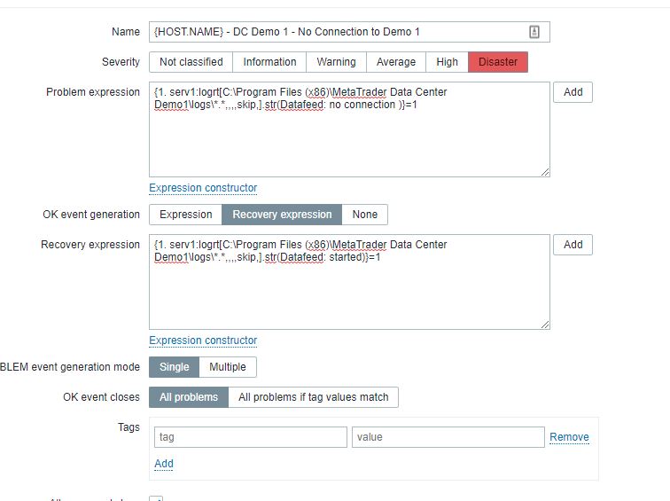

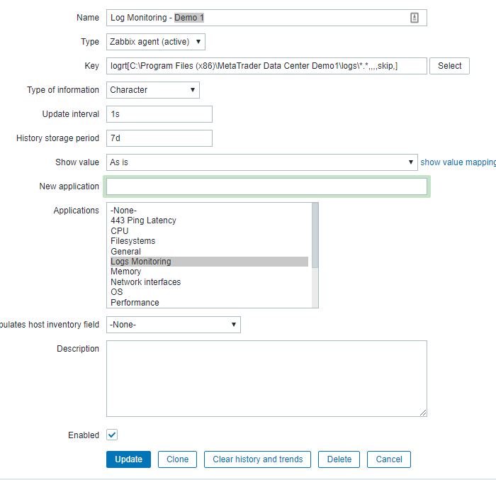

      Hello all,
      I need your help as well with logrt.
      So I have updated my zabbix agents on 2 of my servers to v3.4 and now my logrt is not working on them. On the rest servers which I have v3.2 its working fine.
      see below screenshots of my Item and Trigger... Please note that the log files I am monitoring have this format: 20170911.log and every day it changes to the next day 20170912.log ...20170913.log etc etc.
      The error I get is:
      3752:20170911:093116.157 active check "logrt[C:\Program Files (x86)\MetaTrader Data Center Demo1\logs\*.*,,,,skip,]" is not supported: Cannot compile a regular expression describing filename pattern: ? * + invalid at offset 0
      If there is a different way on which I can monitor these kind of files (20170912.log ...20170913.log etc etc.) I will appreciate it if you share it with me.

        Hi n3o,
        In Zabbix 3.4, the processing of regular expressions has been changed.
        However, I think the regular expression that was originally set up is not appropriate.
        In regular expressions, "*" means to repeat the character specified before.
        "." Indicates an arbitrary character. It does not indicate "."(period) Itself.
        The previous settings just happened to match the filenames you wanted to monitor.
        Please correct the file name of the argument of logrt[] to a more correct regular expression.
        ex.
        logrt[C:\Program Files (x86)\MetaTrader Data Center Demo1\logs\[0-9].*.*,,,,skip,]
        logrt[C:\Program Files (x86)\MetaTrader Data Center Demo1\logs\[0-9].*.log,,,,skip,]
        Adjust the setting according to the file name of the output log.
