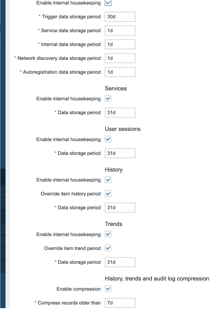

    These are the settings I have in the GUI

    If you have set global values to 31d, then you can mark whatever in your item config, it will be overrun. Your DB is probably not shrinking as there is nothing to shrink...
    If some setting in server/proxy/agent config file is commented, it means it uses "default" value, which does nto have to be specified. Only if you want to change it, you uncomment the line and add your own value.
