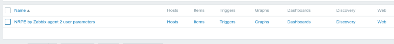

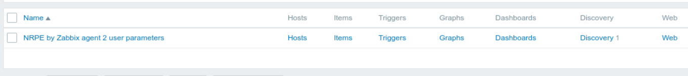

    Here's a screenshot of the template when imported with the web interface:
Name:	Screenshot From 2026-05-13 16-13-47.png
    And when imported with the API:
Name:	Screenshot From 2026-05-13 16-13-21.png
    I've also confirmed that exporting it after importing it via the API similarly shows the discovery rule missing.

    After rubber-ducky debugging, figured out the issue. It's desired Zabbix behavior. By default, the configuration import API requires you to specify each type of thing you're importing. The following script worked:
