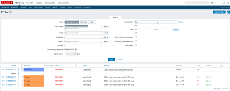

                  I assume that you are using the default templates, yes? Could you please show how the problem lookslike(screenshot) and name you version of server, proxy and agent.

                    Hi Alex,
                    I am indeed using the default template. This template is applied to all Proxies. The Zabbix Server template is applied to the server as well.
                    Sure, please see the screenshot below:-
                    So the proxy in question is zbx-rd-prx1, which has all the checks assigned to it, and should be the only one that triggers the "Zabbix Poller process more tha 75% busy" however, this seems to trigger for all three, zbx-rd-prx1, zbx-rd-prx2 and zbx-rd-srv1.
                    The versions for all are '1:3.2.7-1+jessie'.
                    Thanks again.
