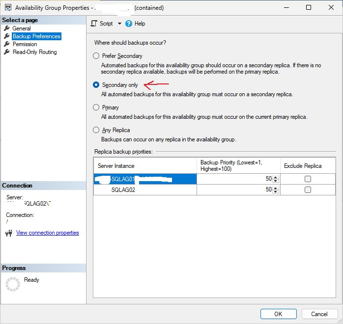

I use latest zabbix-agent2-plugin-mssql.exe mssql plugin.
Problem: MS SQL 2022 Availability Group, when in AG I set that Secodary AG Replica is the Prefered Backup Replica (see pic bellow)
In this case MSSQL plugin wrongly states, that backup has not completed on Primary Replica on AG Databases.
After some research I checked the query, that Zabbix MSSQL plugin sends:
https://git.zabbix.com/projects/AP/r...backup.get.sql
this query only checks, if the AG Replica is primary --> then it returns all databases,
if the AG Replica is secondary --> then it returns only local databases.
Iz ignores the AG Backup preferences config.
So it would make sense to rewrite the query "last.backup.get.sql":
(I checked; it works on SQL 2016 and later)
-- 1. Original hardcoded Query
-- 2. Corrected Query
