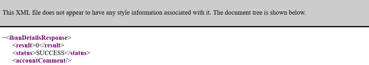

    This is my output URL :
    So I want to get value status that is showing success from this output
    I did follow steps :
    Create an HTTP item while due parse or get value :
    {"paymentCode":"0","paymentCodeValid":"0","errorCo de":null,"errorMsg":null,"result":"0","status":"SU CCESS","accountComment"}
    Also I know we have to use preprocessing . Would you please help me ? Please correct me if that is not correct also please help me how can just show status value that is here "SUCCESS" to create trigger according that

      But what do you want to get?
      If only 1 value is important, than after you did the xml to json stop add extra step like Jsonpath: $.paymentCode
      (you can set item value to integer for better storage)
      When you want more values stored: leave item value of you http item > create dependant items from http item> use jsonpath like above per item value

        Value: {"paymentCode":"0","paymentCodeValid":"0","erro rCo de":null,"errorMsg":null,"result":"0","status":" SU CCESS","accountComment"}
        preprocessing: Regular exprression - SUCCESS - \0
        result: SUCCESS
        Note: If you want a numeric value, I recommend REPLACE value "SUCCESS" to a boolean value in the second step and then to numeric (Boolean to decimal) in the third step. Don't forget that the collected value is "text" at the beginning. (Edit the item accordingly.)
