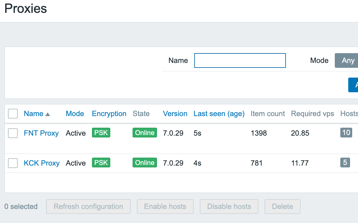

      Under Administration -> Proxies -> the proxy is seen with a matter of seconds:
Name:	Screenshot 2026-08-18 at 4.54.22 PM.png
      The proxy in question is FNT Proxy.

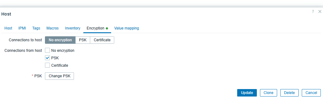

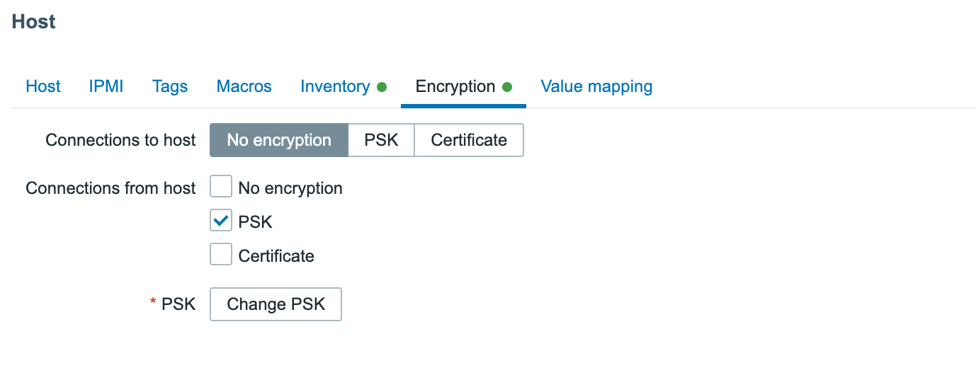

      I have 'No encryption' for 'Conections to host' and PSK for 'Connections from host':
Name:	Screenshot 2026-08-18 at 4.56.20 PM.png
      Later tonight I'll try completely disabling PSK for one of the hosts to see if that changes the behavior

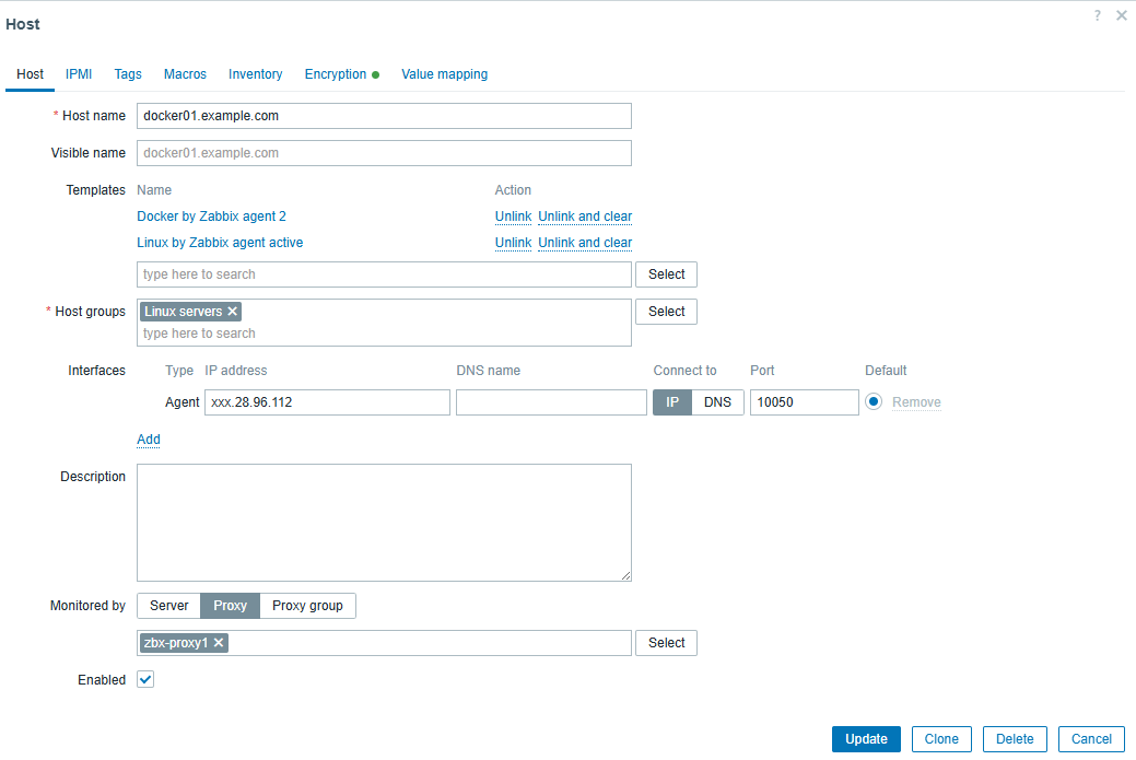

        • in host settings Linux by Agent active is using active checks, but Docker template is using passive checks, so interface is needed for the host, has this been setup?
        Example log entry -
        3830:20260819:094541.428 In zbx_async_check_agent() itemid:50981 key:'docker.container_stats["/test-redis"]' host:'docker01.example.com' addr:'xxx.28.96.112' conn:'unencrypted'
        3830:20260819:094541.429 End of zbx_async_check_agent():SUCCEED
        ​My host config in frontend -

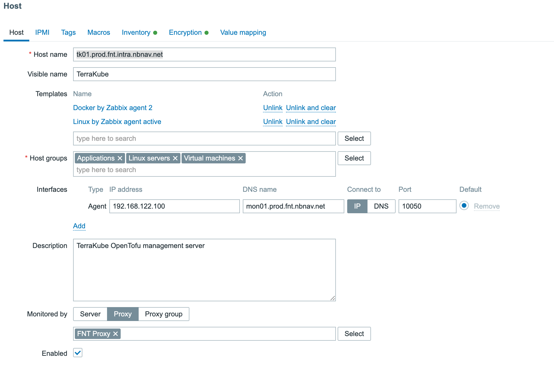

          Here is the host setup:
Name:	Screenshot 2026-08-19 at 9.00.31 AM.png
          I unlink and cleared Docker by Zabbix agent 2 and re-added it to see if something was stale there but it still hasn't picke dup any data for the host dashboard as-of-yet.
