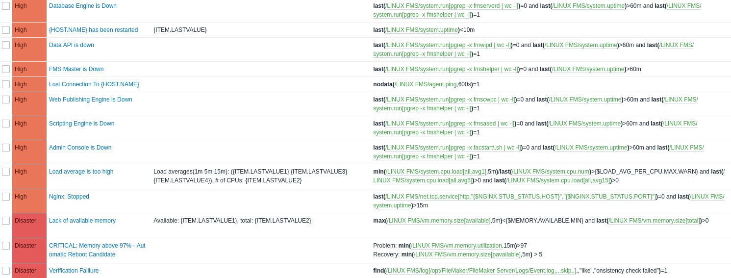

    I would like to implement this structure to the way my triggers occur. I have tried many options but it never seems to work.
    Trigger name:
    FMS Master is Down
    Expression:
    last(/LINUX FMS/system.run[pgrep -x fmshelper | wc -l])=0
    and
    last(/LINUX FMS/system.uptime)>60m
    Trigger name:
    Scripting Engine is Down
    Expression:​
    last(/LINUX FMS/system.run[pgrep -x fmsased | wc -l])=0
    and
    last(/LINUX FMS/system.uptime)>60m​
    and
    last(/LINUX FMS/system.run[pgrep -x fmshelper | wc -l])=1

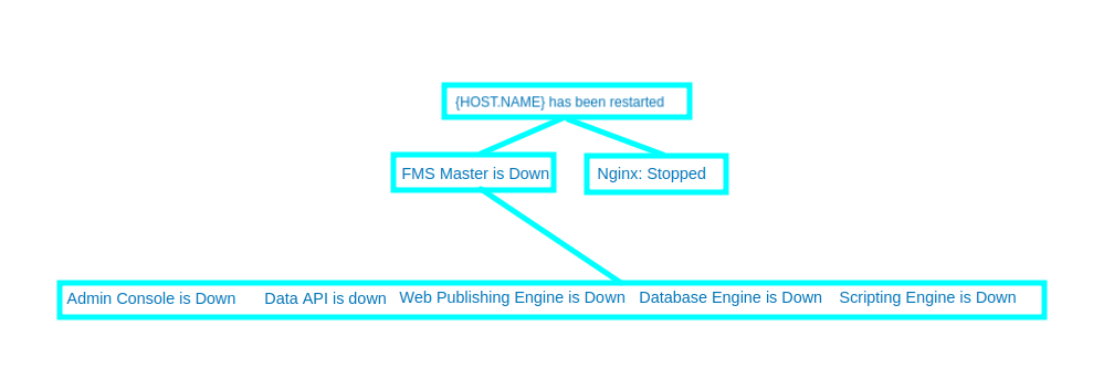

    I tried to make it that it gives it an hour before it says something but it still sends all the messages to the users when the server is restarted. We don't want it to send us these triggers unless the system hasn't been restarted, because its already implied these processes are down. If FMS Helper Service goes down, all FMS sub-processes go down with it. Nginx does not, but we do not want Nginx to only alert us if it down, not if the system restarted, causing it to be down with it. If anyone could please help, that would be very lovely!

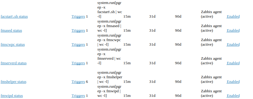

    Here is my current infrastructure.

    3. Scripting Engine matches your point about sub-processes going down with FMS Helper.
    Name: Scripting Engine is Down
    Expression: min(/LINUX FMS/system.run[pgrep -x fmsased | wc -l],30m)=0
    Dependencies: Recently rebooted
    FMS Master is Down
    Do the same for any other FMS sub-process. Since they depend on both the reboot trigger and the master trigger, you get one alert (Master) instead of a storm when it takes everything else down with it.
