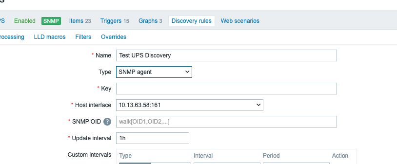

          With a simple device, like a UPS, what Key do I put in to "write something useful"? If I have a Tripp-Lite template that has the list of information I want to get for any UPS, would I have to fill out this discovery rule?

            If you want to discover things, then key "ups.discovery" is OK. Your SNMP data arrives as "text". If you "get" an item, it can return a integer or float also, so choose correct one you need.
