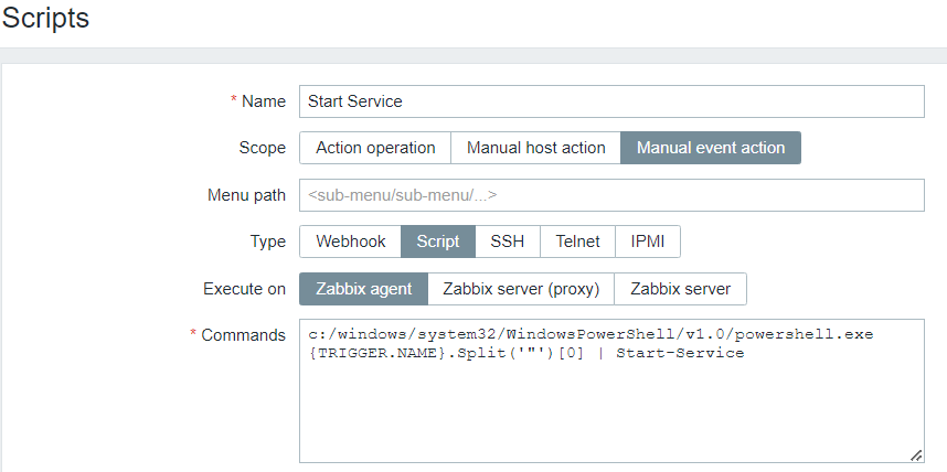

              Is there any solution for making available the name of the service when running the script from the problem dashboard?
              Thank you.
              Cristian

                So {ITEM.VALUE} isn't working? Atleast for me it's working, I've created script for manual event action and from there i do get value which is assigned to event. Script used for testing: echo {ITEM.VALUE} {TRIGGER.NAME} >> /tmp/test_dummy.txt

                  markosa , thank you very much for your input. It works with the {TRIGGER.NAME}. Previously I was trying on the host menu instead of event menu that's why it did not work.
                  Though I am still not able to extract a piece of information from the {TRIGGER.NAME}.
                  This is my code:
                  c:/windows/system32/WindowsPowerShell/v1.0/powershell.exe {TRIGGER.NAME}.Split('"')[0] | Start-Service
                  The {TRIGGER.NAME} returns the text in this form: "abc-cloud-config-server" (ABC Cloud Config Server) is not running (startup type automatic) . What I need is to get only the first part of the string which in our example is abc-cloud-config-server
                  Any ideas?
                  Thank you.

                    How about {ITEM.VALUE} or {ITEM.VALUE1} or {ITEM.VALUE2} ? What does those return? I think that you should have within some value that service name, trigger name is partly built from item values/names

                      markosa {ITEM.VALUE} returns "Stopped (6)" while {ITEM.VALUE1} and {ITEM.VALUE2} return null.
                      I was able to make it work though by putting {TRIGGER.NAME} under quotes.
                      This is the working code:
                      c:/windows/system32/WindowsPowerShell/v1.0/powershell.exe '{TRIGGER.NAME}'.Split('"')[0] | Start-Service
                      Thanks again for your help.
