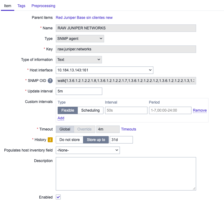

    i have a rare problem with data collection from SNMP Bulk Request.
    this is Master Item:

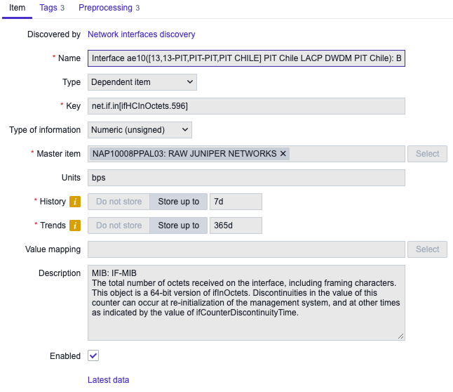

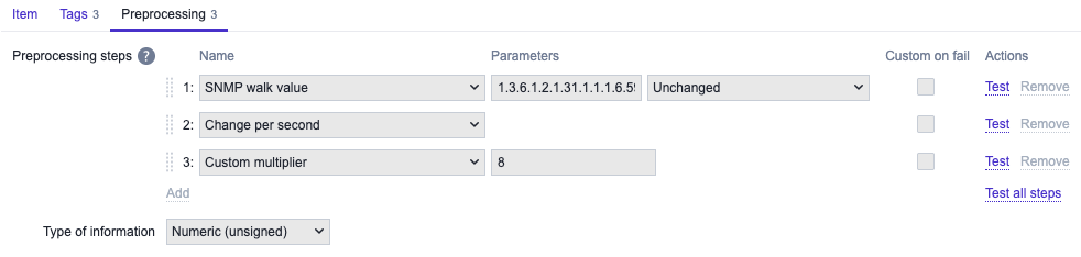

    and this is dependent item:

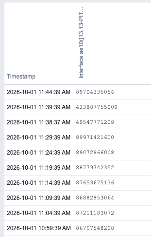

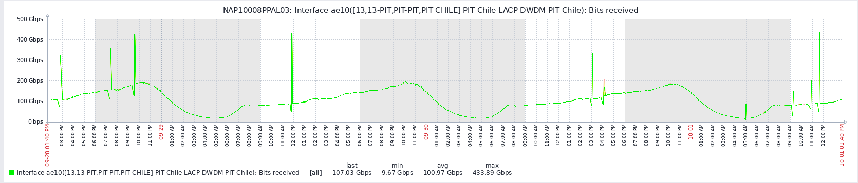

    the dependent item sometimes do not poll on the configured time (5 minutes in the master item) and this produces strange peaks in values:
    in the last polling, it tooks 9 minutes to poll a new value, after that only took 1 minute and generate that strange value (400Gb aprox.)
    what could it be causing this behavior?

    Problem solved: the problem was: Global SNMP Timeout. i changed it from 4m to 10s.
