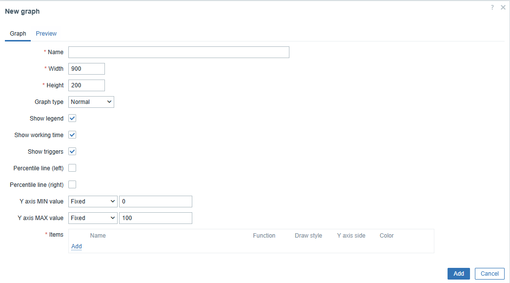

    I assume you're just graphing by clicking the graph button in the latest data page?
    If you create a graph in the host (or template) you can set Min and Max values for the Y Axis

        Thanks for the suggestion. I wasn't aware of that way of making graphs. Its not as versatile since I have to make a graph per site but it will work for now.
